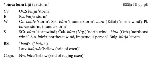

Derksen reconstructs the Proto-Slavic word for "storm" as *bura:
Which sound does 'u' represent here? As far as I know, Proto-Slavic /u:/ (known as "jeri" in Croatian literature, "sharp i", usually denoted as *y) changed to /i/ in Croatian, whereas Proto-Slavic /u/ (also known as "back yer" or, in Croatian literature "jor", usually denoted as *ъ) changed either to /a/ in Croatian or disappeared due to the Havlik's Law. Proto-Slavic /u/ doesn't regularly give /u/ in Croatian. So, which sound does the 'u' in *bura represent?

Derksen doesn’t actually say outright what vowel notation he’s using, but he does specify what stage of Proto-Slavic he reconstructs (my emphasis):
The reconstructed etyma represent a late stage of Proto-Slavic, posterior to the loss of glottalization under the stress and Stang’s law. Quantity, tone and stresse[s] are marked accordingly (see 3.5) The most recent development that I have taken into account is the shortening of the falling tone in word-forms of more than two syllables, e.g. *sь̏rdьce.
Based on this, you’d expect him to use the Slavicist style of representing vowels, and looking at his reconstructions, it’s clear that this is indeed what he does. That means that in Derksen’s reconstructions, the following applies:

For the lexeme *bùŗa, then, the Late-Proto-Slavic pronunciation reconstructed by Derksen is /bura ~ burʲa/.

If you look at Derksen’s reconstruction, he gives the Proto-Balto-Slavic (“BSl”) form *bouʔr-, which contains precisely the diphthong *ou that we would expect to yield the Proto-Slavic u /u/ he reconstructs for *bùŗa.
As far as I know (but again, I’m no Slavicist, so correct me if I’m wrong), Late Proto-Slavic /u/ has remained /u/ fairly consistently in the Slavosphere – in the Wiktionary entry on Proto-Slavic *buřa, Modern Czech bouře is the only descendant that doesn’t have /u/ anymore, and that’s a much later inner-Czech development.
