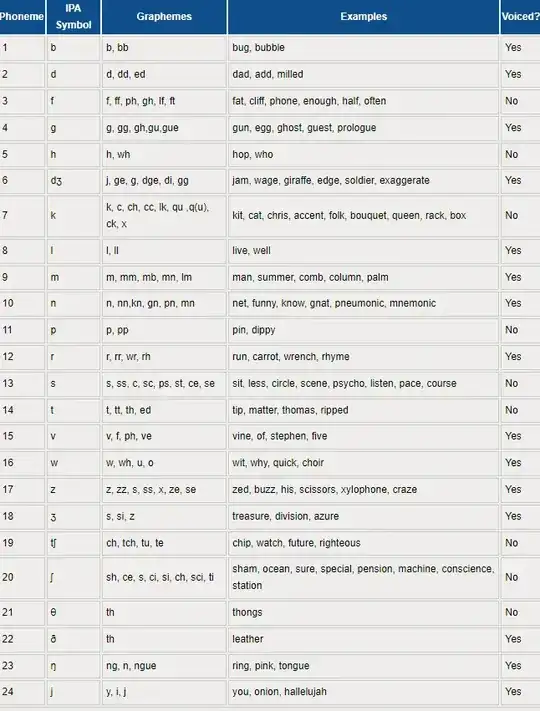

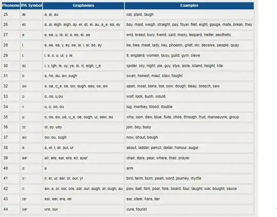

I am new to Natural Language Processing and the first thing that I encountered is phoneme representation of a word. I am wondering how come "hello" gets converted to "HH AH0 L OW1"? From where does this numbers comes along with the representations like AH0 and OW1? I went through these 2 charts but could not find any numerical representation like this. I am attaching the charts
Can anyone guide me from where does this numerical representations like AH0 and OW1 comes?
