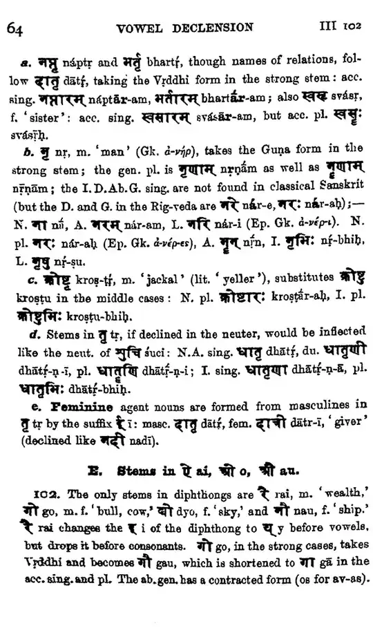

Sanskrit nouns stems ending in dipthongs are very rare but I could still find examples of at least one stem each ending in every dipthong except e‌ ए.
ऐ ai - रै rai
ओ o - गो go
औ au - नौ nau
But I could not find any noun stem in e ए. Every book or online tutorial that mentions dipthong ending noun stems mentions only these these but they say nothing about e. Is there any noun stem ending in e ए in Sanskrit?
http://www.learnsanskrit.org/references/nouns/vowels A Sanskrit Grammar for Students by Arthur A. Macdonell
    By which should we assume you mean in "the nominative singular", and not "the dative sg.; vocative sg., n-a dual"? But then, your examples don't, so you must actually have in mind a specific phonological theory where "रै" has a diphthong. Which theory? – user6726 Nov 12 '20 at 16:53
    I do not mean in "the nominative singular" or in any other declension, I am asking about the stems that end in e, ai, o and au, of which I see examples of only ai, o and au and no example of stems ending in e. – Sumit Mishra Nov 13 '20 at 02:53
    I don’t think there are, actually. Never thought about that before. Even some of the ones mentioned on the page you include are fairly irregular synchronically, so it’s questionable whether they should really be called diphthongal stems or just irregular; I wouldn’t really call go an o-stem, at least. Theoretically, there could have been e-stems as well (ei-or oi-stems in PIIr. terms), but if there were any, they all seem to have been levelled out into other declensions as best I can think. – Janus Bahs Jacquet Nov 13 '20 at 12:53
