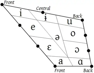

    If you look at a diagram of the English vowel phonemes, you see that there are tight contrasts between tense and lax vowels in the front and the back (/i/ ~ /ɪ/, /e/ ~ /ɛ/, /ɔ/ ~ /o/, /ʊ/ ~ /u/), but no contrasts at all in the center -- just /ə/. That means that the entire central vowel region consists of allophones of /ə/, enough to fit into any environment. This dovetails nicely with the necessity to reduce unstressed syllables in a stress-timed language. – jlawler May 10 '19 at 13:36

The Association also recommends that the letter ə be employed to denote any unrounded vowel situated in the interior triangle (see Fig. 4). If a language contains two unrounded central vowels, it is recommended that ə be used to denote the closer one and ɐ for the opener one. Occasionally the form ɜ may be employed to represent another variety of central vowel.
Fig. 4:
It was only in 1993 that [ɘ ɵ ɜ ɞ] came to represent the current values, and they are still little employed as defined in the current IPA.
