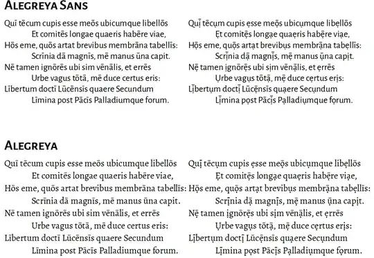

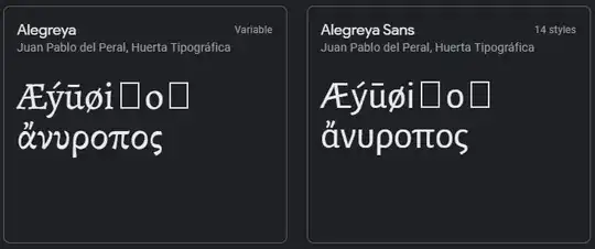

EB Garamond is not a big fan of combining dot below, which I use for poetry (ictus). Another font which I find very pleasing, is the Alegreya family, especially since it has both regular and sans-serif types.
Here are some samples (the sample text below is ‘Æýūøĭọ ἄνυροπος’ [Sorry about that, folks; it is two in the morning, and it was supposed to say ἄνθρωπος – well, it still gets the job done, even though it’s gibberish.]):

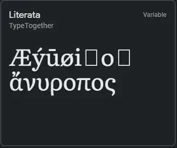

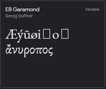

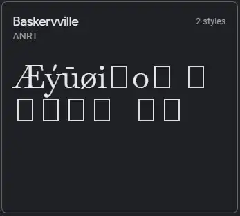

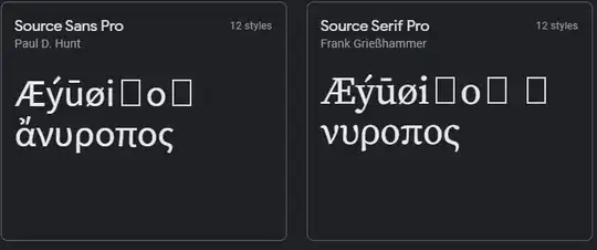

EB Garamond, Latin extended and Greek polytonic Baskerville, Latin extended and Greek polytonic Alegreya Regular and Alegreya Sans, Latin extended and Greek polytonic Literata, Latin extended and Greek polytonic Source Serif and Sans, Latin extended and Greek polytonic
Baskerville stands out as a no-go: Though it looks excellent on-screen, it has no support for Greek. The other ones all look fine. EB Garamond generally isn’t that great on-screen (it never was designed for it), though it does work if set larger; Liberata is quite fat, but does work on-screen; but both of these only come as seriffed, which make them rather undesirable for my needs. Alegreya and Source Pro are both good candidates, as they come in both seriffed and sans-serif styles; they both support Greek polytonic, though Source Sans Pro does not. However, these too both have lacking support diacritics. The option I have used thus far, is OpenSans, which is yielding this mess:

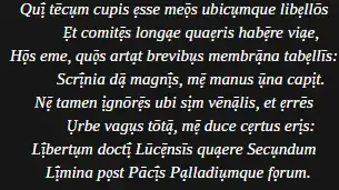

Even in LibreOffice, with all the necessary OpenType features switched on, it doesn’t look desirable:
Sample of Latin text with macrons and combining dot below (Martial 1.2)
(Martial 1.2)
Notice how ī with combining dot below constantly gets messed up. With the serif specimen, it is at least somewhat acceptable, but with the sans-serif, it is simply not.

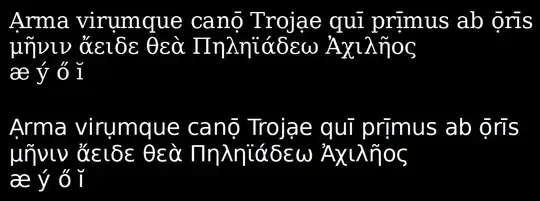

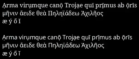

I would recommend Noto, which attempts to represent all of Unicode in a consistent style. It's available for free in both sans and serif versions.
sample text rendered in Noto
I'm generally pretty happy with it; you can see in this image that the i with macron and underdot in prīmus is slightly misaligned, but I'm not sure if that's a font issue or an editor issue. (In this example I used a precomposed underdot and a combining macron; the other way around may look better, but editor issues are making it irritatingly difficult to input at the moment.)
The sample text I used, if others want it for comparison:
Ạrma virụmque canọ̄ Trojạe quī prị̄mus ab ọ̄rīs
μῆνιν ἄειδε θεὰ Πηληϊάδεω Ἀχιλῆος
æ ý ő ĭ

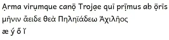

Another free option is DejaVu, from an older project with the same aim as Noto (i.e. trying to cover as much of Unicode as possible). I don't like its look quite as much, but it was my go-to for obscure symbols or mixtures of different scripts back before Noto.
sample text in DejaVu
The kerning seems a bit weird here, and a couple of the diacritics are placed strangely, but it does support all the glyphs you're interested in.

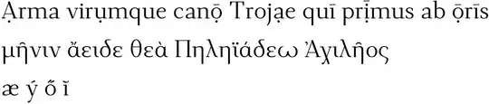

Gentium Plus covers the Latin, Greek, and Cyrillic scripts, as well as the IPA, and seems to support the sample texts very well.
Screenshot of sample text
Gentium is freely published under the SIL Open Font License.
