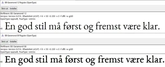

It is quite common for a good typeface to be delivered in for example 8 pt and 12 pt optical sizes. Take a look at the below example:
Font sample EB Garamond 12 Regular and EB Garamond 08 Regular

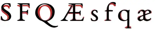

The upper font sample is in what in Germanic countries are known as Cicero size: 12 point size; it is based on a font size cast at 12 points, and is a good choice for text which is meant to be body text. The lower sample is cast at the so-called Petit size: 8 points. This means it is a good font size for example for foot notes. Notice how it is wider, has a slightly modified shape, and appears to be quite bold; in fact it is not. Rather, it is meant to be displayed at a smaller size, and to appear to have the same font weight as the 12‑point size, it has to be wider and fatter to appear to be of the same weight. Here are a couple of letters stacked on top of each other; red is 8‑point and black is 12‑point optical size:
EB Garamond 12 superimposed over EB Garamond 08

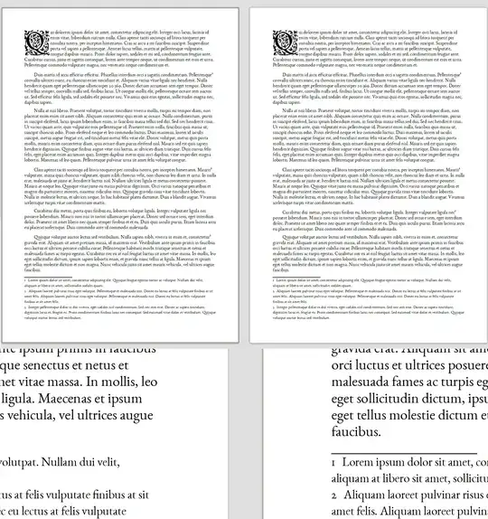

Both text samples are rendered at the same size, but the 8‑point optical size has slightly wider serifs, slightly wider downstrokes, and in this case is in fact a bit shorter. Here is an example of two pages side by side, the left where all text is rendered in 12‑point optical size, the right with footnotes rendered in 8‑point optical size, whilst the body text is rendered in 12‑point optical size.
Example of two exactly similar pages in EB Garamond, with left page in only 12-point optical size and right page with footnotes rendered in 8-point optical size
Notice how the footnotes on the left-hand side appear to be more slender and how their weight appears obviously lighter than the body text; this is because it is the wrong font weight for that text size. On the right hand size, the footnotes appear to be more or less of the same level of ‘blackness’ on the page as the body text; this is because it is rendered in the 8‑point optical size, which is designed for text that small.
