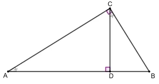

S. Strogatz in this article, published a month ago in The New Yorker, defies, based on [5, pp. 3-4], the consensus among several biographers of Einstein (Hoffmann included) as to how it was that Einstein's proof of the Pythagorean theorem actually went. According to Schroeder (and Strogatz), Einstein considered, just as in the figure below, the altitude to the hypotenuse $AB$ of the right-angled triangle $ABC$:
Then, on the one hand, Einstein has that $\triangle ABC \sim \triangle CBD \sim \triangle ACD$ and that
$$\mathrm{area}(\triangle CBD) + \mathrm{area}(\triangle ACD) = \mathrm{area}(\triangle ABC). \qquad \mbox{(*)}$$
On the other hand, if
$$\mathcal{A}:= \mathrm{area}(\triangle CBD),$$
then
$$\mathrm{area}(\triangle ACD) = \left(\frac{b}{a}\right)^{2}\mathcal{A}$$
and
$$\mathrm{area}(\triangle ABC) = \left(\frac{c}{a}\right)^{2} \mathcal{A}$$ (it has to be recalled that, according to Eucl. VI-19, the ratio of the areas of two similar triangles is equal to the square of the ratio of any two corresponding sides). From this and $(*)$, it follows that
$$\mathcal{A} + \left(\frac{b}{a}\right)^{2}\mathcal{A} = \left(\frac{c}{a}\right)^{2} \mathcal{A};$$
obviously, the Pythagorean theorem is an immediate consequence of the above equality.

  • How do you get $\mathrm{area}(\triangle ACD) = \left(\frac{b}{a}\right)^{2}\mathcal{A}$ ? – skan Dec 18 '16 at 01:50
    @skan: "the ratio of the areas of two similar triangles is equal to the square of the ratio of any two corresponding sides..." – José Hdz. Stgo. Jan 06 '17 at 01:51
