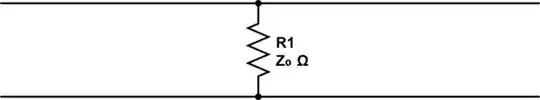

The "un-intuitions" I have are related to inline components like a feed-through terminator with a resistor from (in coaxial terms) the center conductor to the shield:
A resistor joining across two long parallel wires

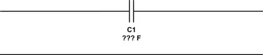

…and/or a DC-block coupler, which is basically a capacitor interrupting the center conductor:
A capacitor in series along one of two long parallel wires

To solve the first circuit:
  1. Divide the transmission line into two lines, one on the left, one on the right.
  2. Zoom in to the centre portion. When you are in a small ($\ll\lambda$) region, the normal rules of circuits apply. You have an impedance on the right, a parallel resistor, and terminals for connection on the left.
  3. Work right to left. Assuming the Right transmission line is correctly terminated, it presents an impedance of $Z_0$ otherwise work it out from $Z_0$ $Z_L$ $\beta$ and $x$.
  4. Now place a resistor of $Z_0$ in parallel, the resulting impedance is $Z_0/2$
  5. This is what the Left transmission line sees as its terminating impedance.
  6. Zoom out and do the normal transmission line equation if you want to know the impedance at some point on that line.
The second question can be solved in the same way. You're correct, the impedance of a capacitor is dependent on frequency, but in practice if the capacitor is large, the impedance will be effectively zero for all frequencies you're interested in. For example, 10 nf at 7 MHz is $2.2 \Omega$ and at 145 MHz is $0.11 \Omega$, neither will have any significant effect on the line if $Z_0=50\Omega$
Here's a circuit for the first one.
schematic
simulate this circuit – Schematic created using CircuitLab

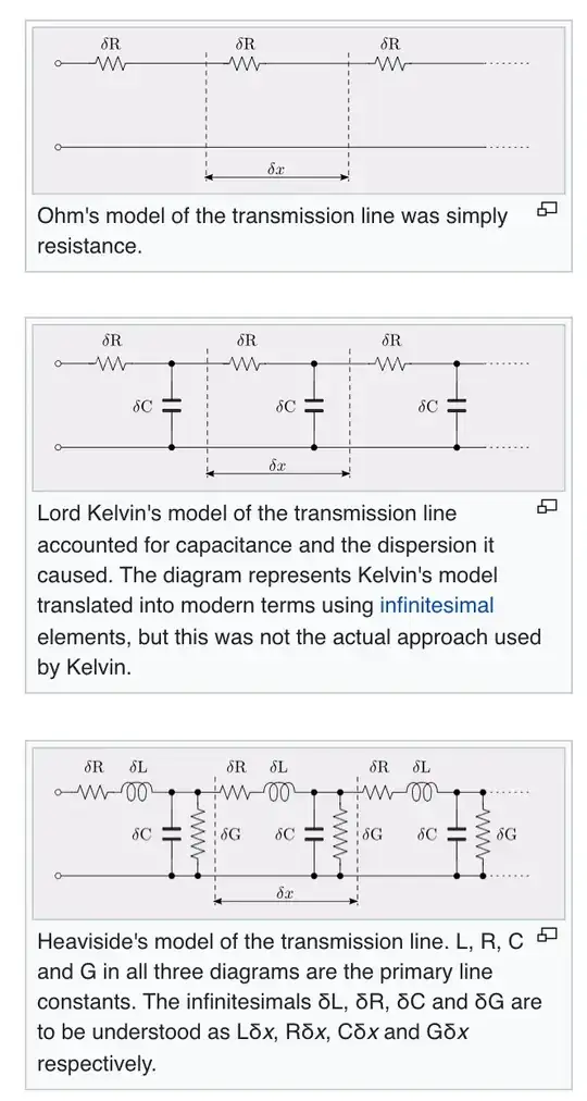

So I still don't really "get" transmission lines, and this is hardly a complete answer, but in an interesting turn of events I found these diagrams on Wikipedia:
Three diagrams showing Ohm's model, Lord Kelvin's model, and Heaviside's model of the transmission line — each a long chain of progressively-more-complicated filter-looking elements
So, perhaps, every spot in a coax is something of a tiny filter too?!
