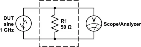

I think the correct way to understand this is basically as "a dummy load which makes it easy to measure the voltage across itself".
Likely as simple as:
a 50ohm resistor in parallel with both a DUT signal source and a scope/analyzer
simulate this circuit – Schematic created using CircuitLab
That is, for a feed-through terminator, the input port provides a characteristic impedance load assuming the output port is connected to a load of (ideally) infinite impedance. So the terminator provides the whole load and only a ± open circuit (i.e. a non-load) is meant to be "fed" by it — power in, voltage [only] out.
As the quote in my question hints at, the idea is that this lets you connect a device-u'wanna-test (DUT) which is expecting a 50Ω load to something like a high-impedance oscilloscope input without a mismatch.
Whereas with an attenuator there's a more complicated resistor network which provides a load assuming its output is also a load of characteristic impedance. So the load is shared between the attenuator and what it feeds — power in, power [reduced] out.

    This is correct. In particular, they're frequently used with oscilloscopes, which conventionally have 1 MΩ input impedance (though usually on a BNC connector, not SMA). [feel free to / please do add this to your answer] – Kevin Reid AG6YO Dec 03 '21 at 23:06
  • @KevinReidAG6YO Thanks for the confirmation. The note about oscilloscope usage is kind of already in the question — though admittedly that's my fault… the downside of figuring out an answer while typing up my own question :-) – natevw - AF7TB Dec 03 '21 at 23:09
  • Sounds like you're saying, that a feed through test load, is designed to be monitored in parallel by a high impedance device like a scope ?? I've never heard of them before, thanks for the post. – wbg Jan 13 '22 at 17:31
  • @wbg Yep, that's my understanding. – natevw - AF7TB Jan 17 '22 at 01:55
