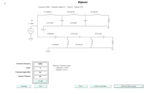

Short story: 2m/70cm diplexer, to be used up to 50W.
Schematic from Elsie: Schematic

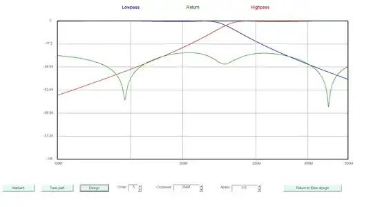

S21/S11: S21/11

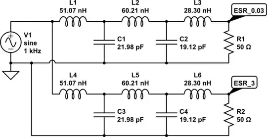

CircuitLab built into this site should also work:
schematic
simulate this circuit – Schematic created using CircuitLab

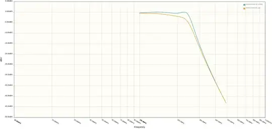

Click "Simulate", then "AC analysis", and you can generate this plot:
This compares two implementations of the top half of your diplexer. The blue line shows the circuit build with caps with a 0.03 ohm ESR, and the orange line is 3 ohms ESR.
The result of 3 ohms ESR is about 0.5 dB of insertion loss. If you plot at higher frequencies you can also see the stopband attenuation is worse (though at high enough frequencies, ESL also becomes significant, and that's not modeled here).
Of course the ESR and parasitic capacitance of the inductors matters too. Since you're using air-core inductors there won't be any core loss, so ESR is just the resistance of the wire with adjustments for proximity and skin effect.
Simulation will also help you find the current and voltage each component is subject to, which will help with the other selection criteria in the other question.
