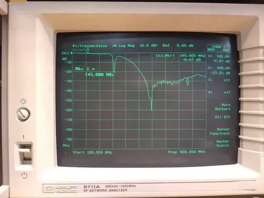

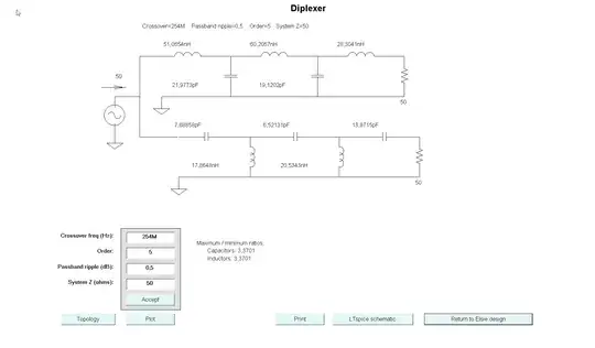

Just made my first 2m/70cm diplexer. Important: I aim to be able to use this up to 50 Watts. layout with broken 0603 caps S21 from the LP section: S21 LP section
Having access to regular distributors such as Farnell/Element14, Mouser, Digikey,... I searched for RF capacitors with a voltage rating of over 200Volts, and only found SMD parts. Most of them 0603. In theory not an issue, in practice they don't handle the stress of the inductors very well. Some of them cracked quite quickly and it's clear this is not permanent option.

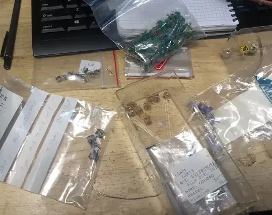

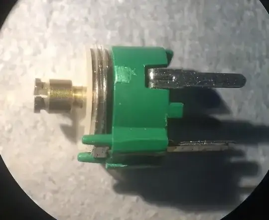

  • I have a bunch of these variable capacitors (gift from a -now SK- elmer), but no specifications. They do trim to all the values I'd need, but since there is just a tiny bit of space between the plates, I suppose these won't be useable (or at least not for long) for my application?
Close-up of the plates (there's a thin layer of plastic in between): enter image description here

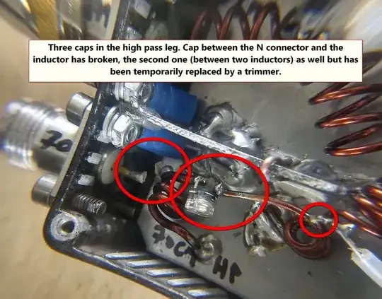

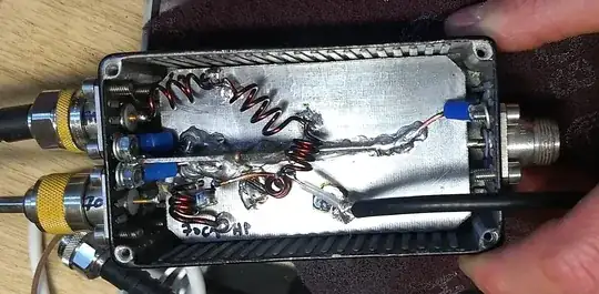

[EDIT] I think the issue is with my construction technique.
I've tried to keep lengths as short as possible, maybe too short. In the lowpass leg for example, I soldered the capacitors tombstone (standing up) to the grounplane and soldered the inductors directly to the capacitors. So one side of the cap is literally the connection point for two inductors.
The start of the high-pass leg is a capacitor soldered to the center pin of the n connector, with an inductor soldered to the other side. That mechanical force of that inductor has torn the capacitor in two (possible to see that in the last picture below, bottom left).
I guess I should better cut out "pads" in the ground plane to serve as connection points instead of using the capacitors as direct connections? Feels a bit stupid now...

    I would really like to see the schematic with the component values. –  Jul 07 '20 at 17:09
    @TylerStone added schematic, though it is pretty basic. The issue (I now think) is with my physical construction, not the choice of capacitors... – Dieter Vansteenwegen ON4DD Jul 07 '20 at 20:03

I bet you can make this work reliably with an SMT MLCC. You just need something bigger than an 0603. If you switch to leaded capacitors you're going to have a much harder time finding high frequency data since the lead inductance starts to become significant at hundreds of MHz.
I'd suggest searching with manufacturer tools rather than distributor tools. You'll find the manufacturers have better tools that will provide more data so you can make the right part selection.

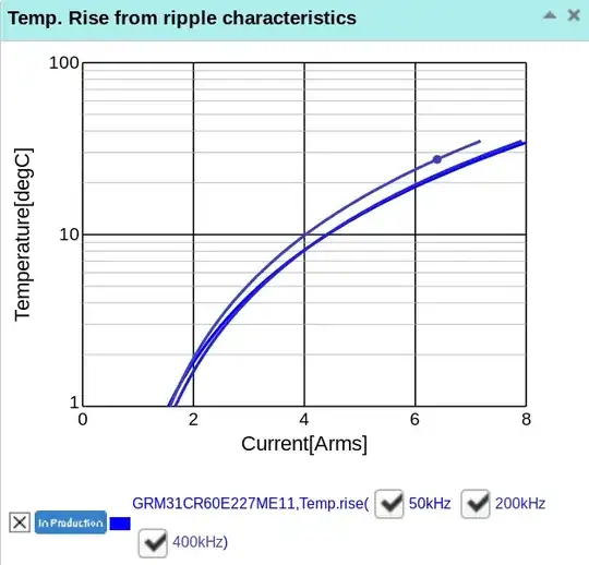

For example, muRata has SimSurfing. If you look at the MLCC tool, select a part (or a few parts) and then go to "Characteristic Graph" -> "Individual Characteristic Data" -> "Temp rise", and you can get a little graph like this:
You can also get plots of the dissipation factor (DF), complex impedance, and all kinds of other stuff that will help you not only ensure the capacitor won't overheat and crack, but also select a capacitor with low losses so that your diplexer will have sufficient performance.
Be sure to do a little analysis or simulation of your circuit to find the RMS current and peak voltage, which could be a lot more than what you'd expect from just 50 watts into 50 ohms. And be sure to build in a healthy safety margin. Remember larger packages can dissipate more heat, so you may need to look for devices with a higher voltage rating just for the larger package, even if you don't need to handle that much voltage.
I just picked muRata as an example, but every major manufacturer has something like this. Usually a search for "[manufacturer] mlcc selection tool" will find it.
While I suspect you do need bigger capacitors to make this work, and you can get better performance with a larger capacitor as well, additionally I'll suggest an alternative construction technique. MLCCs are very fragile (they are a bunch of thin, brittle ceramic layers, after all) so you definitely don't want any mechanical strain on them.
One solution is to etch out little pads on the main board for the caps.
If you don't want to do that, you could cut little pieces of board with the copper cut away in the middle, solder the caps to that, and then solder the inductors to the board. This way the PCB takes all the strain. Also keep in mind the PCB acts as a heat sink, so you might want to deliberately keep these mini-boards wider than necessary.

  • Phil, thanks for taking the time to respond, but I'm afraid the source of my question begs a much simpler response (I think I just used a stupid way of mechanically soldering things together). I guess I should place isolated pads on the ground plane, and use those to make connections instead of having everything hanging freely in the air. (see the added text in my question edit) This will lead to longer leads but I guess that's the way to go. I mean something like this: https://www.parasitstudio.se/building-blog/manhattan-style-pedalbuilding – Dieter Vansteenwegen ON4DD Jul 07 '20 at 20:10

    @DieterVansteenwegenON4DD something marketed as an "RF Capacitor" will have low ESR and ESL. Low ESL means no leads. That's not to say building a circuit at 500 MHz with leaded capacitors, but you'll have to make adjustments to compensate for that parasitic inductance, and you may have a hard time finding technical data for anything with leads at 500 MHz. – Phil Frost - W8II Jul 07 '20 at 20:17

  • @DieterVansteenwegenON4DD Yeah, sounds like you understood correctly despite the missing phrase. You want ESL and ESR to be "as low as possible". Either will limit the filter performance. You can do some math or simulation to quantify how much it will hurt performance, but that's probably best done as a separate question. – Phil Frost - W8II Jul 07 '20 at 21:08
  • @DieterVansteenwegenON4DD In fact from your photo it looks like you're getting only 25 to 30 dB of stopband attenuation, which is pretty poor. – Phil Frost - W8II Jul 07 '20 at 21:13
  • "only 25 to 30dB of stopband attenuation, which is pretty poor" Well thank you for kind words of appreciation ;). Will have to work on it, but it's a start. – Dieter Vansteenwegen ON4DD Jul 09 '20 at 11:48
  • @DieterVansteenwegenON4DD I'm just saying, with better capacitors you can probably improve that by some 10s of dB. Better meaning lower ESL and ESR. – Phil Frost - W8II Jul 09 '20 at 12:44
