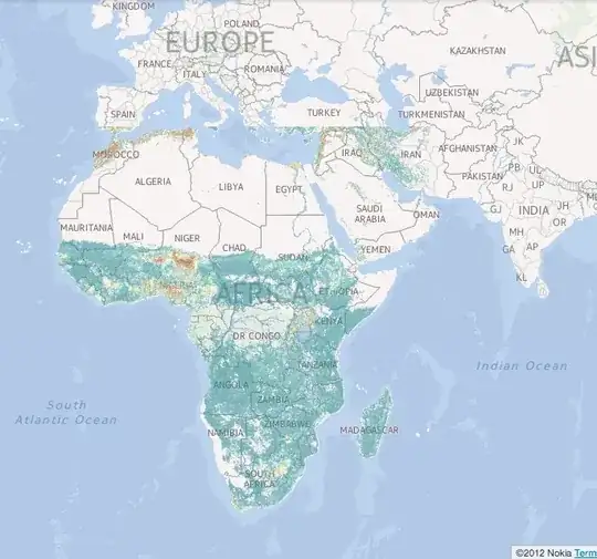

In answer to my own question, I've written a program to "vectorize" an ArcInfo Grid ASCII files as an ESRI shapefile with a single layer containing oriented polygonal grid squares centered at the points of the grid, with an attribute value equal to the value at the coordinates of the centroid. The program (still under development) is available on GitHub. An example of a map produced with the program is on CartoDB (it might not be for long). Perhaps one could have done this in GRASS. Space for detailed answers in this vein is provided below.
In case the map has to be taken down, here is a screen capture Ramankutty cropland

The previous version of the program produces large files. The latest version takes an ArcInfo Grid ASCII file, identifies the polygonal boundaries of annular regions directly in raster space, and writes out an ESRI shapefile. Following ESRI conventions, polygonal boundaries are oriented clockwise, and holes are oriented counterclockwise. Because the program runs in row-column coordinates, error-free computation is used to identify digital topology--geographic coordinates are written out only when the shapefiles are created. Local heuristics are used to identify new regions and holes; the heuristics can lead to decisions that have to be corrected later, but the use of local incremental heuristics is no worse on the average than identifying global geometric features directly. A histogram calculation was used to classify values by quantiles (equal value division is also available). The illustration below was a screen shot of a shapefile layer produced by the program (Annual Runoff in the Niger River Basin, year 2000, with cropland utilization 25% above year 2000 levels). Annual Runoff in the Niger River Basin, year 2000, with cropland utilization 25% above year 2000 levels. Other examples: Ramankutty Cropland and runoff in the Niger River Basin again: enter image description here
