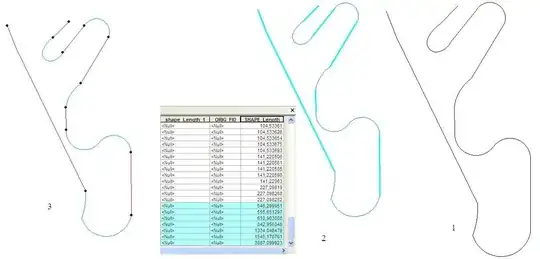

You can use the Densify tool. For this case, you choose to densify by angle, Next, choose the the maximum angle accepted in a straight line. Then apply to result line to the tool Split line at vertices. Finally, delete the lines having shape_length smaller the minimum road length.
In this picture, we see three steps:
1- Densify the line using angle. I have used 10 degrees as the parameter, and we used splitline. In the picture, the curved line is in its initial phase.
arcpy.Densify_edit("line" , "ANGLE" , "","",10)
arcpy.SplitLine_management("line" , "line_split")
2- Select the segments where having shape_length not redundant. As we see in the table, I have not selected those redundant lengths. Then, I select them into a new feature class.
arcpy.Select_analysis("line_split" , "line_split_selected")
3- We have extracted the vertices located in the edges of the lines, which are inflection points.
arcpy.FeatureVerticesToPoints_management("line_split_selected" , "line_split_pnt" , "DANGLE")

  • I have the same comments and questions concerning your other answer: it's a nice idea, but at the same time it's not clear that it will produce the desired result, nor how one should choose the threshold angle. Could you provide an illustration of the output so readers can evaluate what this proposal really does? Providing worked examples is especially important when recommending ESRI software as part of a solution, because their algorithms usually are not documented, making it impossible to know exactly what they are doing. – whuber Oct 18 '12 at 17:15
  • to be very sure that is a working solution , i need to test it, but i can't test it, i'm missing the data,so i suppose that the proposed tools by ESRI gonna work like expected, but this answers need to be tested further. – geogeek Oct 18 '12 at 17:25
  • we could name them ideas and not answers – geogeek Oct 18 '12 at 17:25
    Would you like me to move them into comments, then? BTW, if you want data to test, you could--for a start--use the coordinates I posted in my answer, because they're close to the illustration in the question. But why not just use any geographic data you have handy? – whuber Oct 18 '12 at 18:33
  • @whuber i have made an update containing a test that i have made , so the solution works perfectly – geogeek Oct 18 '12 at 20:14
  • Thank you! (+1). But I feel obliged to point out that your solution misses a few isolated inflection points (considering an IP as a place where the curve "swings" from a left turn into a right turn or vice versa). What I like most about your solution is that it (cleverly) exploits a capability already available within ArcGIS. – whuber Oct 18 '12 at 20:25
    yes really this solution is working better at extracting just straight lines. – geogeek Oct 18 '12 at 20:36
