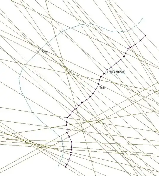

Using ArcMap's near tool, I have 'projected' the vertices of a trail onto a corresponding line (river), in order to find the closest point on the river to each trail vertex. However, as you can see in the screenshot, not all the trail points (from the green line) have found corresponding near points on the river... I tried first with no search radius and again with a search radius of 2000 m (the distance between the river and the trail in the area is under 300 m).
How can I find all the corresponding near points along the river? enter image description here

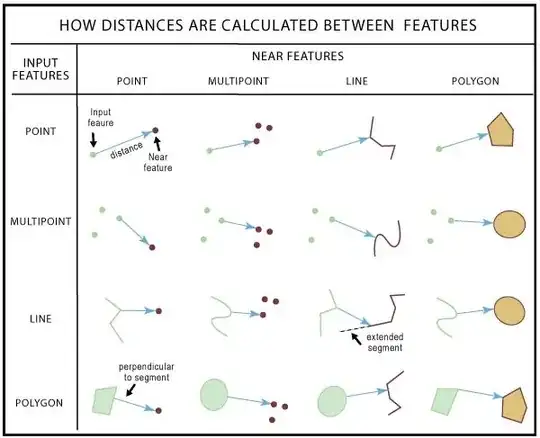

Using the "Near" Tool may not be the best option in this case. From the help file:
The distance between any two features is calculated as the shortest separation between them, that is, where the two features are closest to each other.
So, using your example, it looks like the reason the points along the river (to the north of your screen shot), are not being picked up because the distance to the vertices to the east and west are closer. Also bear in mind the proximity tools in ArcMap use a set of rules to define distance:
Rule 1: The distance between two points is the straight line connecting the points
Rule 2: Distance from a point to a polyline is the perpendicular or the closest vertex
Rule 3: Distance between polylines is determined by line segment vertices
This is summarised in the following table - again from the help file: enter image description here

  • Oh yeah, this makes sense! I was trying to get the perpendicular from the point to the river using the near tool and had reviewed the documentation for Near before but it didn't occur to me, somehow that those 'blank' parts of the river are farther and thus the near points don't show up on them. From the visual it just seems intuitively that some of the 'blank' part of the river are actually be closer to some of the trail vertices. I'm going to look into your suggestions. – user112188 Jan 22 '18 at 14:18
  • @maps_spam Maybe try densifying the vertices in the river feature. Eyeballing the curve it looks like there aren't many. Which would explain why visually it seems there may be discrepancies in your output. – Keagan Allan Jan 22 '18 at 16:46
  • I'm not trying to find the nearest vertex on the river though, only the nearest point on the river - should be anywhere on the river, not necessarily a vertex. – user112188 Jan 22 '18 at 16:52
  • Sorry I should have clarified. By densifying the number of vertices on the river you increase the chances of one of the proximity tools identifying a point along the river. That is, if you decide to go with one of the proximity tools. – Keagan Allan Jan 22 '18 at 17:27
  • How would that work? I meant earlier that I don't think the Near tool only seeks out vertices to identify as Near points; it can also find (or in this case, 'create', in a sense) Near features (points) on the line in the absence of defined vertices. – user112188 Jan 22 '18 at 19:51
  • I think I muddied the water here. Yes, the Near Tool is perhaps not the solution for you here, perhaps the "Point Distance" Tool is a good place to start. By Densifying the vertices it may give you a better representation / distribution of vertices to run these tools off of. I have a bit of time today, I will try and replicate a scenario as you have shown and see if I can identify a workflow. – Keagan Allan Jan 23 '18 at 07:51
  • Yeah, I tried Point Distance but wasn't sure how to proceed since it calculates the distance from each point to all the others? I've also tried the linear referencing toolbox, by converting the lines into routes and the points into events along those routes - with the Locate Features along Routes tool and related tools - but there are still plenty of gaps where the vertices from each of the river and trail don't seem to perpendicularly 'project' or transpose onto the corresponding line. – user112188 Jan 23 '18 at 10:55
  • Just a small query, are you wanting to get the point along the river which is perpendicular to the point from your Trail vertices? – Keagan Allan Jan 23 '18 at 12:29
  • Yeah, that would be ideal. (I know I didn't put that in my original question, just because I thought using Near tool was the solution to automatically find the perpendicular (based on Rule 2 of proximity)). – user112188 Jan 23 '18 at 13:51

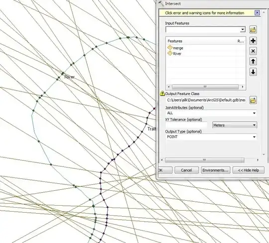

Below please find the examples of the Inputs and Output.
Replication of your example
Below please see how the tool appears (1 - the original tool from the link and the circle...as the PYT appears)
The output: enter image description here
Intersecting, green dots are the corresponding points: enter image description here

        # Process: Add Field (6)
        arcpy.AddField_management(Converted_Graphics_7__7_, "Angle", "DOUBLE", "", "", "", "", "NON_NULLABLE", "NON_REQUIRED", "")
        # Process: Calculate Field (6)
        arcpy.CalculateField_management(Converted_Graphics_7__13_, "Angle", "[rad] * (180 / 3.14159265)", "VB", "")
        # Process: Add Field (7)
        arcpy.AddField_management(Converted_Graphics_7__12_, "EastWest", "DOUBLE", "", "", "", "", "NON_NULLABLE", "NON_REQUIRED", "")
        # Process: Calculate Field (7)
        arcpy.CalculateField_management(Converted_Graphics_7__15_, "EastWest", "[StartX] - [EndX]", "VB", "")
        # Process: Add Field (8)
        arcpy.AddField_management(Converted_Graphics_7__11_, "NorthSouth", "DOUBLE", "", "", "", "", "NON_NULLABLE", "NON_REQUIRED", "")
        # Process: Calculate Field (8)
        arcpy.CalculateField_management(Converted_Graphics_7__17_, "NorthSouth", "[StartY] - [EndY]", "VB", "")
        # Process: Add Field (9)
        arcpy.AddField_management(Converted_Graphics_7__16_, "Azimuth", "DOUBLE", "", "", "", "", "NON_NULLABLE", "NON_REQUIRED", "")
        # Process: Make Feature Layer
        arcpy.MakeFeatureLayer_management(Converted_Graphics_7__19_, Output_Layer, "", "", "FID FID VISIBLE NONE;Shape Shape VISIBLE NONE;OBJECTID OBJECTID VISIBLE NONE;ARCID ARCID VISIBLE NONE;GRID_CODE GRID_CODE VISIBLE NONE;FROM_NODE FROM_NODE VISIBLE NONE;TO_NODE TO_NODE VISIBLE NONE;ET_ID ET_ID VISIBLE NONE;Shape_Le_1 Shape_Le_1 VISIBLE NONE;Year_ Year_ VISIBLE NONE;Shape_Leng Shape_Leng VISIBLE NONE;Name Name VISIBLE NONE;Azimuth Azimuth VISIBLE NONE;StartX StartX VISIBLE NONE;StartY StartY VISIBLE NONE;EndX EndX VISIBLE NONE;EndY EndY VISIBLE NONE;rad rad VISIBLE NONE;Angle Angle VISIBLE NONE;EastWest EastWest VISIBLE NONE;NorthSouth NorthSouth VISIBLE NONE")
        # Process: Select Layer By Attribute
        arcpy.SelectLayerByAttribute_management(Output_Layer, "NEW_SELECTION", "\"NorthSouth\" > 0")
        # Process: Calculate Field (9)
        arcpy.CalculateField_management(Export_Output_3_Layer, "Azimuth", "[Angle] + 180", "VB", "")
        # Process: Select Layer By Attribute (2)
        arcpy.SelectLayerByAttribute_management(Export_Output_3_Layer__3_, "NEW_SELECTION", "\"NorthSouth\" < 0 and \"EastWest\" > 0")
        # Process: Calculate Field (10)
        arcpy.CalculateField_management(Export_Output_3_Layer__4_, "Azimuth", "[Angle] + 360", "VB", "")
        # Process: Select Layer By Attribute (3)
        arcpy.SelectLayerByAttribute_management(Export_Output_3_Layer__2_, "NEW_SELECTION", "\"NorthSouth\" < 0 and \"EastWest\" < 0")
        # Process: Calculate Field (11)
        arcpy.CalculateField_management(Export_Output_3_Layer__6_, "Azimuth", "[Angle]", "VB", "")
        # Process: Select Layer By Attribute (4)
        arcpy.SelectLayerByAttribute_management(Export_Output_3_Layer__5_, "NEW_SELECTION", "\"NorthSouth\" = 0 and \"EastWest\" > 0")
        # Process: Calculate Field (12)
        arcpy.CalculateField_management(Export_Output_3_Layer__7_, "Azimuth", "270", "VB", "")
        # Process: Select Layer By Attribute (5)
        arcpy.SelectLayerByAttribute_management(Export_Output_3_Layer__9_, "NEW_SELECTION", "\"NorthSouth\" = 0 and \"EastWest\" < 0")
        # Process: Calculate Field (13)
        arcpy.CalculateField_management(Export_Output_3_Layer__11_, "Azimuth", "90", "VB", "")
        # Process: Delete Field
        arcpy.DeleteField_management(Export_Output_3_Layer__8_, "StartX;StartY;EndX;EndY;rad;Angle;EastWest;NorthSouth")
        # Process: Select Layer By Attribute (6)
        arcpy.SelectLayerByAttribute_management(Output_stuff, "NEW_SELECTION", "\"Azimuth\" < 365")
        # Process: Select
        arcpy.Select_analysis(copy_Layer, Output_Feature_Class, "Azimuth <= 365")
        arcpy.AddMessage ("Azimuth calculated")
#back
        arcpy.AddField_management(Output_Feature_Class, "left", "DOUBLE", "", "", "", "", "NON_NULLABLE", "NON_REQUIRED", "")
        # Process: Add Field (2)
        arcpy.AddField_management(copy_Select, "right", "DOUBLE", "", "", "", "", "NON_NULLABLE", "NON_REQUIRED", "")
        arcpy.CalculateField_management(copy_Select__2_, "right", "[Azimuth] + 90", "VB", "")
        # Process: Calculate Field (2)
        arcpy.CalculateField_management(splitline_shp__6_, "left", "[Azimuth] - 90", "VB", "")
        # Process: Spatial Join
        arcpy.SpatialJoin_analysis(Trial_FeatureVerticesToPoint, splitline_shp__5_, spatjoin_shp, "JOIN_ONE_TO_ONE", "KEEP_ALL", "OBJECTID \"OBJECTID\" true true false 10 Long 0 10 ,First,#,vertex,OBJECTID,-1,-1;POINT_X \"POINT_X\" true true false 0 Double 0 0 ,First,#,vertex,POINT_X,-1,-1;POINT_Y \"POINT_Y\" true true false 0 Double 0 0 ,First,#,vertex,POINT_Y,-1,-1;POINT_Z \"POINT_Z\" true true false 0 Double 0 0 ,First,#,vertex,POINT_Z,-1,-1;POINT_M \"POINT_M\" true true false 0 Double 0 0 ,First,#,vertex,POINT_M,-1,-1;Dist \"Dist\" true true false 0 Long 0 0 ,First,#,vertex,Dist,-1,-1;Id \"Id\" true true false 10 Long 0 10 ,First,#,C:\\temp\\azimuth.shp,Id,-1,-1;NEAR_FID \"NEAR_FID\" true true false 10 Long 0 10 ,First,#,C:\\temp\\azimuth.shp,NEAR_FID,-1,-1;NEAR_DIST \"NEAR_DIST\" true true false 19 Double 0 0 ,First,#,C:\\temp\\azimuth.shp,NEAR_DIST,-1,-1;NEAR_X \"NEAR_X\" true true false 19 Double 0 0 ,First,#,C:\\temp\\azimuth.shp,NEAR_X,-1,-1;NEAR_Y \"NEAR_Y\" true true false 19 Double 0 0 ,First,#,C:\\temp\\azimuth.shp,NEAR_Y,-1,-1;Azimuth \"Azimuth\" true true false 19 Double 0 0 ,First,#,C:\\temp\\azimuth.shp,Azimuth,-1,-1;left \"left\" true true false 19 Double 0 0 ,First,#,C:\\temp\\azimuth.shp,left,-1,-1;right \"right\" true true false 19 Double 0 0 ,First,#,C:\\temp\\azimuth.shp,right,-1,-1", "INTERSECT", "", "")
        # Process: Bearing Distance To Line
        arcpy.BearingDistanceToLine_management(spatjoin_shp, Left, "POINT_X", "POINT_Y", "Dist", "9001", "left", "9102", "0", "TARGET_FID", "PROJCS['Hartebeeshoek94_Lo31',GEOGCS['GCS_Hartebeesthoek_1994',DATUM['D_Hartebeesthoek_1994',SPHEROID['WGS_1984',6378137.0,298.257223563]],PRIMEM['Greenwich',0.0],UNIT['Degree',0.0174532925199433]],PROJECTION['Transverse_Mercator'],PARAMETER['False_Easting',0.0],PARAMETER['False_Northing',0.0],PARAMETER['Central_Meridian',31.0],PARAMETER['Scale_Factor',1.0],PARAMETER['Latitude_Of_Origin',0.0],UNIT['Meter',1.0]];-5623200 -10002100 10000;-100000 10000;-100000 10000;0.001;0.001;0.001;IsHighPrecision")
        # Process: Bearing Distance To Line (2)
        arcpy.BearingDistanceToLine_management(spatjoin_shp, Right, "POINT_X", "POINT_Y", "Dist", "9001", "right", "9102", "0", "TARGET_FID", "PROJCS['Hartebeeshoek94_Lo31',GEOGCS['GCS_Hartebeesthoek_1994',DATUM['D_Hartebeesthoek_1994',SPHEROID['WGS_1984',6378137.0,298.257223563]],PRIMEM['Greenwich',0.0],UNIT['Degree',0.0174532925199433]],PROJECTION['Transverse_Mercator'],PARAMETER['False_Easting',0.0],PARAMETER['False_Northing',0.0],PARAMETER['Central_Meridian',31.0],PARAMETER['Scale_Factor',1.0],PARAMETER['Latitude_Of_Origin',0.0],UNIT['Meter',1.0]];-5623200 -10002100 10000;-100000 10000;-100000 10000;0.001;0.001;0.001;IsHighPrecision")
        # Process: Merge
        # Process: Merge
        arcpy.Merge_management(WorkingDir + "spatjoin_BearingDistanceToLi.shp" + ";" + WorkingDir + "spatjoin_BearingDistanceToLi1.shp", mergedata, "POINT_X \"POINT_X\" true true false 0 Double 0 0 ,First,#,C:\\temp\\DDP\\spatjoin_BearingDistanceToLi.shp,POINT_X,-1,-1,C:\\temp\\DDP\\spatjoin_BearingDistanceToLi1.shp,POINT_X,-1,-1;POINT_Y \"POINT_Y\" true true false 0 Double 0 0 ,First,#,C:\\temp\\DDP\\spatjoin_BearingDistanceToLi.shp,POINT_Y,-1,-1,C:\\temp\\DDP\\spatjoin_BearingDistanceToLi1.shp,POINT_Y,-1,-1;Dist \"Dist\" true true false 0 Double 0 0 ,First,#,C:\\temp\\DDP\\spatjoin_BearingDistanceToLi.shp,Dist,-1,-1,C:\\temp\\DDP\\spatjoin_BearingDistanceToLi1.shp,Dist,-1,-1;left \"left\" true true false 0 Double 0 0 ,First,#,C:\\temp\\DDP\\spatjoin_BearingDistanceToLi.shp,left,-1,-1;TARGET_FID \"TARGET_FID\" true true false 0 Double 0 0 ,First,#,C:\\temp\\DDP\\spatjoin_BearingDistanceToLi.shp,TARGET_FID,-1,-1,C:\\temp\\DDP\\spatjoin_BearingDistanceToLi1.shp,TARGET_FID,-1,-1;right \"right\" true true false 0 Double 0 0 ,First,#,C:\\temp\\DDP\\spatjoin_BearingDistanceToLi1.shp,right,-1,-1")
        # Process: Dissolve
        arcpy.Dissolve_management(mergedata, Output_Station_Lines, "TARGET_FID", "", "MULTI_PART", "DISSOLVE_LINES")
        return
