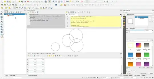

Union the polygons with themselves:
Then adjust and execute code below. It will find the duplicate geometries produced by Union and store their count in a field:
from collections import defaultdict
lyr = iface.activeLayer() #Click union layer
feats = [f for f in lyr.getFeatures()]
opcount = defaultdict(list)
processed = []
for i in range(0,len(feats)):
f1 = feats.pop()
for f2 in feats:
if f1.geometry().equals(f2.geometry()): #Union will produce identical overlapping geometries
if f2.id() not in processed:
opcount[f1.id()].append(f2.id())
processed.append(f2.id())
field_to_update = 'overlaps' #Add integer field before executing code
with edit(lyr):
for f in lyr.getFeatures():
for k,v in opcount.items():
if f.id() in [k]+v:
newval = 1+len(v)
if 'newval' not in locals():
newval = 1
f[field_to_update] = newval
del(newval)
lyr.updateFeature(f)
print('Done')
