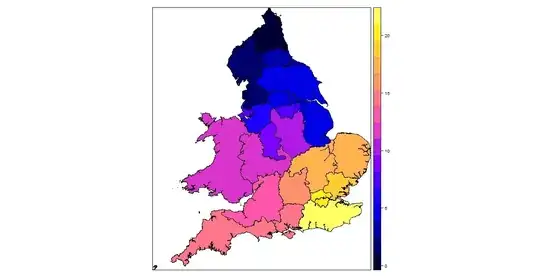

The aggregate has worked, as can be seen by the spplot (note: I found how to aggregate by the regions from this SE post: Join spatial polygons by code in R)
#plot the resulting polygons using spplot
spplot(region_polygons)
But when I fortify the spatial data so that I can use ggplot, there is tearing around the edges.

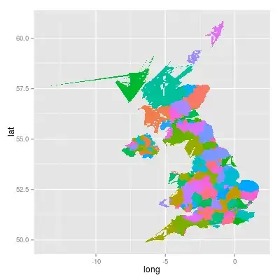

You should you use group=group in the aes mapping. Here is a reproducible example of your problem:
library("ggplot2")
library("raster")
x <- getData('GADM', country='GBR', level=2)
y <- fortify(x, region="NAME_2")
head(y)
#     long   lat order  hole piece      group       id
# 1 -2.049 57.23     1 FALSE     1 Aberdeen.1 Aberdeen
# 2 -2.049 57.23     2 FALSE     1 Aberdeen.1 Aberdeen
# 3 -2.049 57.23     3 FALSE     1 Aberdeen.1 Aberdeen
# 4 -2.050 57.23     4 FALSE     1 Aberdeen.1 Aberdeen
# 5 -2.050 57.23     5 FALSE     1 Aberdeen.1 Aberdeen
# 6 -2.050 57.23     6 FALSE     1 Aberdeen.1 Aberdeen
# wrong group aesthetic
ggplot(data=y, aes(y=lat, x=long, group=id, fill=id)) +
  geom_polygon() +
  guides(fill=FALSE)
wronge aes-group
# fixed plot
ggplot(data=y, aes(y=lat, x=long, group=group, fill=id)) +
  geom_polygon() +
  guides(fill=FALSE)
fixed plot
rcs
  • 3,894
    Thank you @rcs this is exactly the problem. It's fixed now. – annievic Oct 09 '15 at 13:28
    Short explanation: In a fortified spatial polygons data set, id is the feature id, and group is the id of individual rings (islands, holes etc) . So if you draw with id as the group it draws all the bits of your feature as one ring, hence the "tearing" as it jumps between islands. – Spacedman Oct 11 '15 at 11:25
