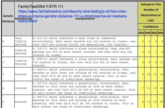

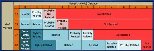

I know Family Tree DNA has explanation tables for 37, 67, and 111, but the way they display the information is different and I would like to have or build an 'all-in-one chart' for each of the levels 12-111, similar to the highlighted section below as well as the following graphic. (which the lower levels do not contain in the linked FAQ pages)
As well as combined the following information in an easy to display reference table for all levels from 12-111 Y-STR DNA tests. (Missing 111)
The above image from a 2010 FamilyTreeDNA Presentation which they described the calculation as complex (with an unrelated whiteboard calculation as a joke).

Part of what I am trying to determine is with different test levels what is reasonable with an assigned confidence level, but also when looking at approaching someone for testing are they close enough of a level to get the answer I am looking for at the time. This comes up as recently I've had some unexpected surprises with a Y-Str testing that has opened new mysteries..
