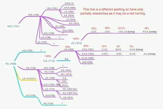

Update: Added Graphic 11/28/2015 To Illustrate what I am trying to link: AS AN EXAMPLE of one of the many things I am trying to tie together: I am a member of the 'J.S.' line, I have members of the 'C.S.' line willing to take the test lined up. We are trying to determine at this point primarily if 'C.S.' and 'J.S.' lines share a common ancestor. Both lines are trying to determine if we are related to the 'M.S.' or 'P.S.' lines but are unsure if DNA testing will really provide any great value in answering this testing at this point due to dilution, and if so what test should we be performing and on whom. The 'C.S' line we do not have a direct male descendant line but the 'J.S.' line does.

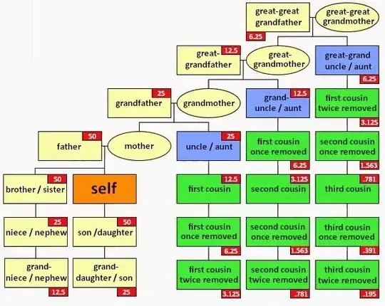

And he gives a very important graph that shows how much DNA you and a given ancestor have in common (on average!): graph
The smaller the numbers the more difficult is it to determine an exact relationship.
Overall (my own opinion) testing either your grandfather or your grand aunts (or all of them) kind of "casts" the net of autosomal DNA the widest. But still your possible connections (E) may be too "far away" to get a significant DNA share.

  • The red numbers indicate the approximate percentage of DNA that the relative has in common with the root person. It is also sometimes given as a range. – Jan Murphy Dec 14 '14 at 17:06
