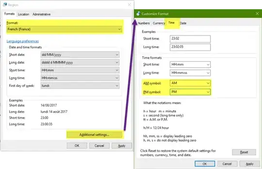

This is specific, easy-resolvable case. If you are localizing the software, then date, time, currency, number format and other localization resources are already available for you to use, so why re-invent the wheel?
In all major operating systems, there already is a set of locales with all settings already translated for most common countries and languages. Just let your software ask current settings from the operating system and you are fine. This with give French users their currently set 24-hour time format (if they did not change it in settings), U.S. users 12-hour time format with AM/PM, their own format to German users etc.
Important: normally, you should not attempt to define these values (AM/PM/time format) by yourself, because typically you want to respect what your users already prefer and what they set on first use of their device. So it is neat to comply. Typical clock applications do exactly that.
Example of settings in Windows: (just pull them for your use)
In rare case if your software is using some operating system where these resources are not present, then just take them from the above for any language you need.
