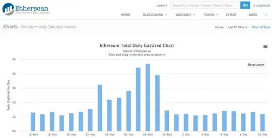

You can see that the daily gasUsed chart below shows the increase in gasUsed during the state clearing period:
