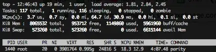

I'm trying to setup personal full node in archive mode (whole history) on server with this parameters:
  • Intel i3 3.4GHz
  • 8GB DDR3 1333 MHz
  • 2TB HDD
  • 100 Mbps / 128
I was expecting issues with HDD speed (despite HDD is quite solid) but I got that ETH node needs some random seeks - unfortunately after renting server.
But now node stopped syncing - my parity logged stopped on
2018-01-24 12:38:59 UTC Syncing #2422928 7d9a…cc9e 0 blk/s 0 tx/s 0 Mgas/s 0+ 7089 Qed #2430018 49/50 peers 12 MiB chain 11 MiB db 42 MiB queue
If I'm getting this right node is on block #2430018 - now its ~5M blocks in ETH blockchain.
I run parity with these flags:
parity --fat-db on --db-compaction hdd --base-path /home/eth_chain/ --mode active --pruning archive --tracing on --logging INFO --log-file /var/log/parity/proc.log
Disk is not full
Filesystem      Size  Used Avail Use% Mounted on
udev            3.9G     0  3.9G   0% /dev
tmpfs           788M   17M  771M   3% /run
/dev/sda2        20G  2.9G   16G  16% /
tmpfs           3.9G     0  3.9G   0% /dev/shm
tmpfs           5.0M     0  5.0M   0% /run/lock
tmpfs           3.9G     0  3.9G   0% /sys/fs/cgroup
/dev/loop0       21M   21M     0 100% /snap/parity/7572
/dev/loop2       84M   84M     0 100% /snap/core/3748
/dev/loop3       21M   21M     0 100% /snap/parity/7576
/dev/loop4       82M   82M     0 100% /snap/core/3887
/dev/sda3       1.8T   43G  1.7T   3% /home
/dev/sda1       487M   69M  389M  15% /boot
/dev/loop5       21M   21M     0 100% /snap/parity/7596
tmpfs           788M     0  788M   0% /run/user/0
I'd allow parity to use more of my hw - its entirely dedicated to this purpose
Have you any advice? Is running ETH full node in archive mode on HDD complete nonsense? - even in --db-compaction hdd mode? With 8GB RAM?
