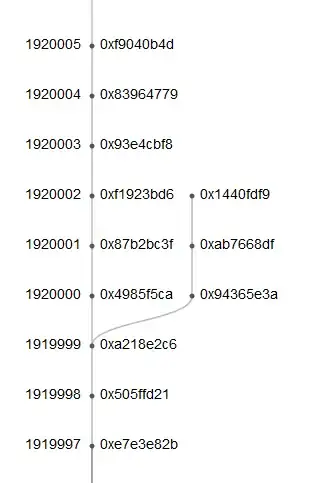

to roll back the transactions miners adopt new rules invalidating some valid blocks thus the belonging transactions are also invalid so we cancel these transactions and we go back to the past the previous state. to do so we need a fork. what's happend in the hardfork in case of the Dao is : we forked the chain at the block 1920000 invalidating all the blocks coming after look at the picture below.
Block 1920000 contained the execution of an irregular state change which transferred ~12 million ETH from the “Dark DAO” and “Whitehat DAO” contracts into the WithdrawDAO recovery contract.
to understand more you could browse and compare the blocks in ethereum and ethereum classic : e.g the last common block between the eteheum blockchain and its fork was 1919999.
https://etherscan.io/block/1919999
http://gastracker.io/block/1919999
read more : https://blog.ethereum.org/2016/07/20/hard-fork-completed/
