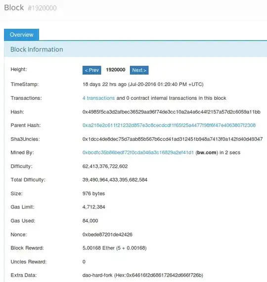

There is an extra data marker in github.com/ethereum/go-ethereum/params/dao.go:
var DAOForkBlockExtra = common.FromHex("0x64616f2d686172642d666f726b")
You can see the DAO hard-fork extra data in #1,920,000: enter image description here
