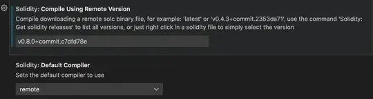

What worked for me is the following:
  1. Type ctrl+SHIFT+p
  2. Select solidity:Change Global compiler version (Remote)
  3. Select your desired solidity version
  4. Additionally, I needed to change in the setting of solidity extension by Juan Blanco. Click on the settings icon and go to extension settings
  5. Set Solidity default compiler option to remote enter image description here

Go to Settings of VS Code. Choose default compiler => remote
choose and copy paste the version you want to support https://etherscan.io/solcversions

If you're using Juan Blanco's Solidity extension for VS Code, besides the compiler version in the truffle-config.js you will also have to change the compiler version of the extension itself. To do that:
  1. Open VS Code command palette by pressing Ctrl+Shift+P
  2. Type Solidity: Change global compiler version (Remote) then press enter
  3. This will open another menu from which you can select the desired version
NOTE: Only changing the extension's compiler version will actually allow you to compile your contract causing some warning. Nevertheless, it is important to also change the compiler version in the truffle-config.js file, because when compiling outside of your VS Code instance, the version specified that file will be used. You can verify that by running truffle compile --compiler in the terminal.
