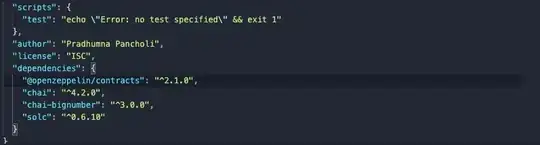

just responding as faced this issue in July 2020 and it took me quite a while to fix it as there aren't many resources for Solidity v0.6
So, here are things that I did to get my code compiled successfully.
  1. Update Truffle, if you installed truffle before a significant amount of time to your development(I used it for a gig 6 months after I installed it as I was just playing around at the time and didn't started learning "actively" until recently).
  2. Set compiler version for in "truffle-config.js" (make sure to use the current version as if you are using a library like OpenZeppelin-Contracts as there might be contracts in there using a different version of solidity than yours.
  1. Usually, the second solution should be enough for you to get up and running. But In my case, I had to manually install "Solc" with "npm install solc" (inside your project directory). This installed solidity compiler 0.6.10 for me.
Yes, it required me to do all three steps to get my code to compile successfully. I hope this helps someone

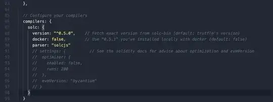

If you just installed Truffle and want to use older version of Solidity, you can simply specifying the compiler version in the truffle-config.js file:
  // Configure your compilers
  compilers: {
    solc: {
      version: "0.5.11", // Fetch exact version from solc-bin (default: truffle's version)
If this doesn't work for you and you are compiling your contracts using VS Code extension, most likely you will have to change the compiler version of the extension. Check this answer to find out more.
If you want to use newer version, you will have to upgrade or re-install Truffle itself. To check the latest version of the compiler, type truffle compile --list
