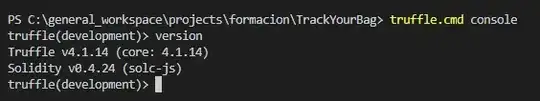

I use Solidity Remix IDE for develop purpose. And when I finish I copy in VisualStudio Code and i attach to my project folder. But visual is telling me that i have a problem with the version. I can compile, migrate and use this contract when I deploy at ganache but the warning still there.
Any idea?

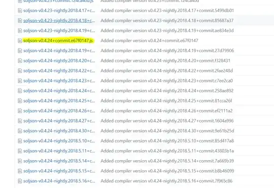

In my Visual Studio Code I use the Juan Blanco extension to help me coding Solidity. The solution is to change in the config json the attributes.
Find the version that yo want to compile in.
Here the web: https://github.com/ethereum/solc-bin/tree/gh-pages/bin

Execute truffle version in a console to see which version you have installed and see which version will be used for compilation.

    I have checked truffle version and it's the same as my pragma version in the contract, but am still getting this error. Also tried solidity.compileUsingLocalVersion set to the same version as truffle... still getting the error. – robertdavid Nov 26 '18 at 13:00
  • Same error. Truffle version is same that I specified in the top of the solidity file. – UnexpectedCharacter Nov 26 '18 at 14:54
