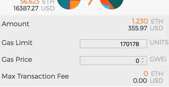

Double check your Gas price. Even I am also setup Gas Price but somehow did applied proper Gas Price as well. One of example below screen shot. enter image description here
David S Lee
