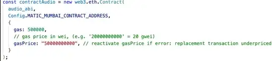

I simply try to mint() on Polygon Mumbai but I had to workaround "replacement transaction underpriced", I still can't see any pending/unmined Tx..nor do I see a Nonce issue
I fixed it by increasing gasPrice to 50 gwei but:
  1. Could help me understand where was the unmined/pending Tx that was blocking? I could see nothing on the Dashboard nor on PolygonScan
  2. I used to be able to send my Tx without setting up the gas attribute, why is it necessary now?
this is my code: enter image description here
