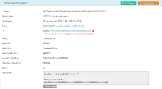

I don't understand why if i execute my function with web3.js i obtain this error in the transaction:
Warning! Error encountered during contract execution [Bad instruction]
I read this other question about the same error. I don't understand why with this code its happening the same:

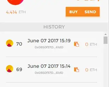

Screenshot of the metamask transactions without any problem:
Screenshot of the EtherScan.io transaction with the error: Screenshot of the EtherScan.io transaction with the error:

Some transactions (all are mine) for view the error:
0x52ef9164750c4e174cba1a5f45343220458f1cedca25380f0aaf102df0a8f895
0x4e00d9d67ffb906e0036434ea2e14acea82a6aabb4d8c99d94c0b2bcdef24f7a
0x4663fa874993d54989d073f72d6846cae652a454349e62882dccc96d78528a8e
0x69fbf54ffd81ee114efcd750d4e97bb528ecc868140abdecf218e9ae66391a5

Your transaction appears to be failing because you're calling it from a different address than you created it with. I walked through the first transaction and noticed that it was skipping an equals test (ISZERO + JUMPI) when comparing against the caller. Sure enough, that transaction was sent from 0x178597064fc55ea505c3ea066c154d92bc264943, but the contract was created by 0xc2351205ee14cdb8b61ffc826ad1906bc7c08755
So, as Thomas posted, the problem is indeed due to the onlyOwner modifier.
It would be helpful to see the code for the owned contract from which yours is inheriting. I'd imagine it doesn't do much more than set owner to msg.sender, but there might be some additional complications in there.
Regardless, if you try sending from 0xc2351205ee14cdb8b61ffc826ad1906bc7c08755 to the contract in the first transaction, it should work.
