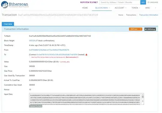

I deploy a smart contract and it shows this error after I see it is created on testnet:
Warning! Error encountered during contract execution [Bad instruction]
When I go to contract code tab, it is empty and just has a 0x there.
Almost like contract created but not completely.
Here is the transaction that created the contract:
https://testnet.etherscan.io/tx/0xaf1adfc8a995068e0f8eb02ad5fa4582244997e4d8b8284165bd18937d6371b9

And when i go to Etherscan i see this:
Warning! Error encountered during contract execution [Bad jump destination]
https://testnet.etherscan.io/tx/0xadd8d2807cc9405ef317f664d86195464afcd62471dc890c9de69ac3a122f31d

  • @RobHitchens Looks like this happens when i try to send Ethers to the contract when deploying it. this used to work before! Can i send Ethers to contract when deploying? – Aram Feb 23 '17 at 21:12
  • Oh wow. That's a (the?) problem. After solc 4.x if I recall correctly, you can't send Ether to any function unless the function is marked with the keyword payable. A constructor can be payable, but if it's not (it isn't), then sending Ether to it causes it to throw an error instead of executing as expected. – Rob Hitchens Feb 23 '17 at 21:15
  • @RobHitchens Yep, adding payable to constructor fixed the issue! – Aram Feb 23 '17 at 22:43

So with the help of @RobHitchens, turns out now after sol 4.x, if i want to send Ethers to a contract at the time of creating the contract, I should put payable to the constructor method (Just like any normal functions in the contract that transfers ethers)
So changed the contract constructor to look like this and works fine now:
function RouteCoin(address _finalDestination, uint _contractGracePeriod)
payable
    buyer = msg.sender;
    contractStartTime = now;
    finalDestination = _finalDestination;
    contractGracePeriod = _contractGracePeriod;
