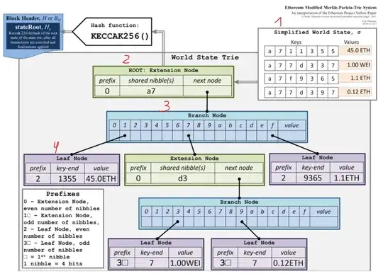

take a look at the following diagram from here:
Here we have a simplified world state. The keys represent addresses and the values represent balances (1)
In this example, the root node (2) is an extension node [encodedPath, key] and we know that based on the hex-prefix. Also note that in this example, all the keys share the same nibble of a7, thus they’re grouped accordingly, an attribute of radix tries. Since the root is an extension node [encodedPath, key] the ‘next node’ bucket will be a hash pointing to the next node, which in this case is a branch node (3)
If we follow the first key in our simplified state (a711355), we use the 1 after a7, to look in the first index of the branch node. This leads us to create a leaf node (4) where if we compare the key and the path, they’re the same, allowing us to skip ahead and leading us to the value or the account balance of 45.0 ETH.
