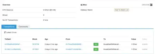

After reviewing my email I followed the link received from shapeshift.io from which I can see this picture:
As far as I see this address received ETHs but how do I get access to them if on my desktop wallet it still says 0 Balance. ?

  • Did you check the transaction on shapeshift using email address followup? Your bitcoin transaction might be late as it has a large backlog. But once that clears ETH should be seen in your account. Check the email to see the transaction and follow up on the number of confirmations (I see that you question was asked just 4 hours ago, so I am guessing it is still in the process of confirmation) – Mandar Jan 18 '17 at 18:02
