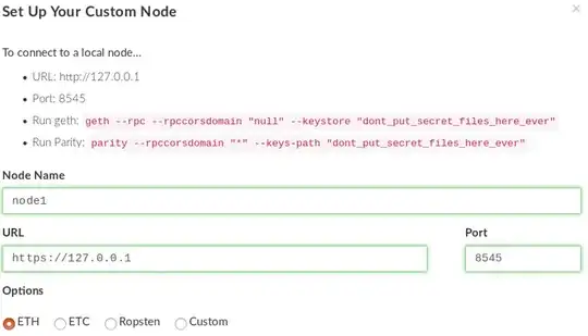

Setup Custom Node:
On the website at http://< my_ip >:8000, Top Right Box => Add Custom Node:
Than I set Node Name: node1, URL: https://<my_ip> and port: 8545 as on the example window popped up.
After that on the top of the page I see the following error:
Please note that I tried < my_ip > as 127.0.0.1 and original ip address of my server but both showed that error. In order to connect to the local node, because of the --rpc flag I assume only localhost can connect into my node. So maybe I need to make modifications on Response.js file via web3 to connect my node?
