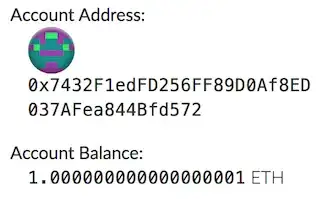

As an example, I can see my correct account balance, where I verified the value also in geth.

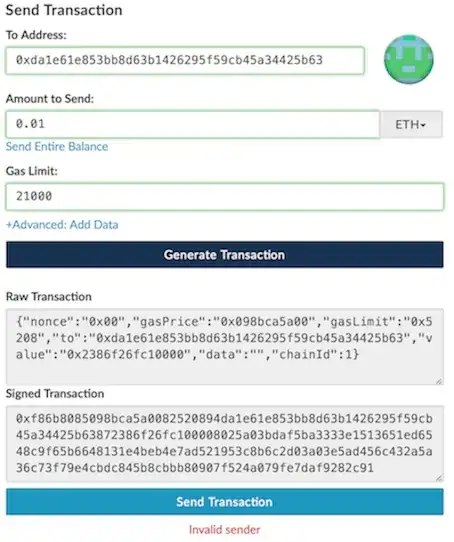

When I tried to send a transaction to a valid account address on my private blockchain, I have faced with the following error: invalid sender.
[Q] What may be the reason of this error and how can I fix it? I am able to complete this transaction inside geth.

    are you using chainId 1 on your private network or do you have a different chainId? do the same setup with EIP155 off and let us know how it goes – kvhnuke Jan 10 '17 at 09:55
    Ah I feel like stupid, On the window popped up when I open Add Custom Node => I didn't checked the box next to Custom and chainID was empty as default value, I did that and it worked. I was using default checked next to ETH which was giving the error. – alper Jan 10 '17 at 10:58
    FYI, the chainId is the identifier for the chain. It was introduced in eip-155 to prevent replays on different chains. Ropsten is 3, eth is 1. If you have a custom ethereum chain, it would be whatever you set it up as. – tayvano Jan 10 '17 at 12:00
