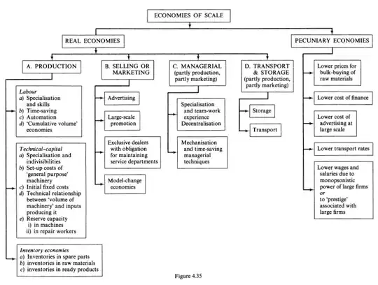

Now what makes economies of scale so wide is that cost of production can decrease due to a variety of variables. Some of these variable are in control of the firm (internal economies of scale) and some are not (external economies of scale). Scale gives firm command over some more variables such as greater power to negotiate wages, less than proportional increase in advertising costs, etc. Most of these are built into production function (especially if we consider non-tangible capital also part of production function).
A very thorough account of causes of economies of scale are captured in the chart below from the referenced book:
