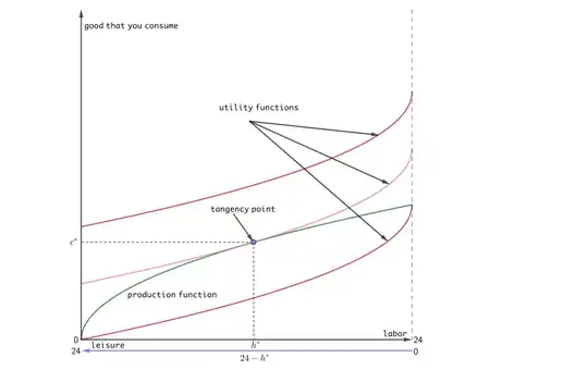

  1. Preferences
Crusoe (just as you and me) likes to have some free time and consume things, so he cares about his consumption $c$ and his leisure $24-h$. You have represented his preferences with a utility function $u(c,h)$ but $h$ is the time he spends on working and he does not like it that much. He prefers leisure over labor, or so we assume. The reason why I am mentioning it is to show you that Robinson actually cares about maximizing his leisure time $24-h$! Here come the usual assumptions about the preferences, they increase with his consumption and leisure time and are convex. We are having easier job, as his utility function was given to us: $u(c,h) = c + \sqrt{24-h}$ BUT when you draw them you can see that they are in fact increasing when you move along the curve to the right (they are increasing with labor $h$). This is the part where it gets tricky - if you drew them with leisure $24-h$ on the horizontal axis, you'd get the proper utility function as you have probably seen before (or can see under "quasi-linear preferences" here: Identifying utility function ).
  1. What choice does Crusoe make?
When we put everything together, we get that the problem is actually something like that: $$\max_{c,h} u(c,h) \;\; \mathrm{s.t.} \;\; c \leq y \;\; \mathrm{and} \;\; y=f(h)$$ This basically means that: Robinson is trying to maximize his utility choosing the level of consumption $c$ and labor $h$, Robinson cannot consume more than he produces and the very last bit is the production technology he is in possession of. Now, remember that we assume that Robinson is utility maximizer. What does that imply?
$c=y$ and therefore, $c=f(h)$
Hence, we can write the problem as: $$\max_{c,h} u(c,h) \;\; \mathrm{s.t.} \;\; c=f(h)$$ Which is the utility maximization problem for this consumer. There are two ways to solve it: Lagrange multipliers or simply constraint substitution into the objective. After you substitute, you'd take first order condition and get something like $$\frac{du(f(h^*),h^*)}{dh}= u_1(f(h^*),h^*)f'(h^*) +u_2(f(h^*),h^*)$$ where $h^*$ is Crusoe's optimal choice of how much hours to work. But you are not given a true production function, so we will not get any further from here.
