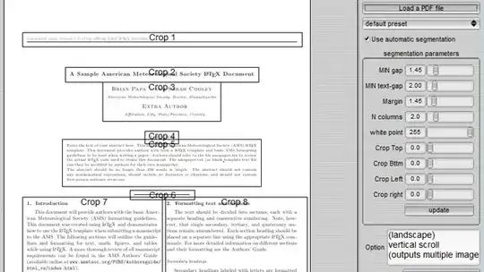

I found PaperCrop a very useful and powerful tool. It is free and highly customizable so you can either relay to automatic detection of columns and sections by program or customize each page format.
