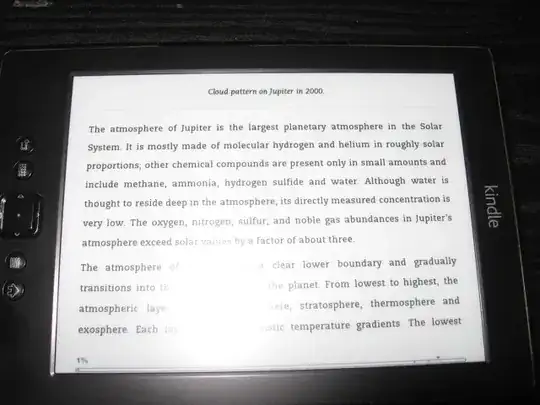

Yes, you certainly can.
The concerns about page size are correct, in normal mode the PDFs will be hard to read. But when you set landscape mode (menu -> screen rotation) they are quite comfortable to read.
Proof (wikipedia site converted to PDF): enter image description here

  • What's a little annoying about this is that each PDF page is usually split into three Kindle-pages, where the third one contains little to no text. – svick Dec 18 '13 at 22:07
  • Yes, it is quite annoying, but I've tried converting many e-books in doc and pdf format to mobi, and there were very many blank lines or lines with a few words, which was more annoying to me. Depends how the document is prepared (line breaks etc.). –  Dec 18 '13 at 22:17
