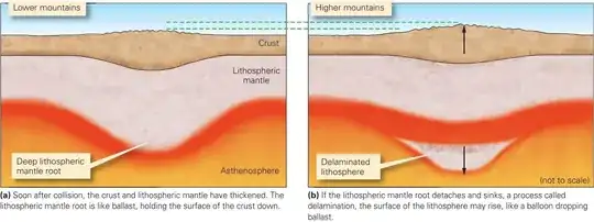

To make matters worse, continental lithosphere can also be destroyed. The most obvious case is erosion from the continents which then settles as a thin sedimentary cover on the oceanic crust and then lost to the mantle during subduction. Another process is delamination. Some rocks such as basalt are normally less dense than the mantle rocks. However, when metamorphosed at high pressure to become eclogite, they paradoxically become denser than the mantle, leading to the bottom part of the lithosphere to be "ripped off" and sink down into the mantle, thus destroying the continental lithosphere from the bottom. Here's a nice visualisation of this process:
Source for the image.
