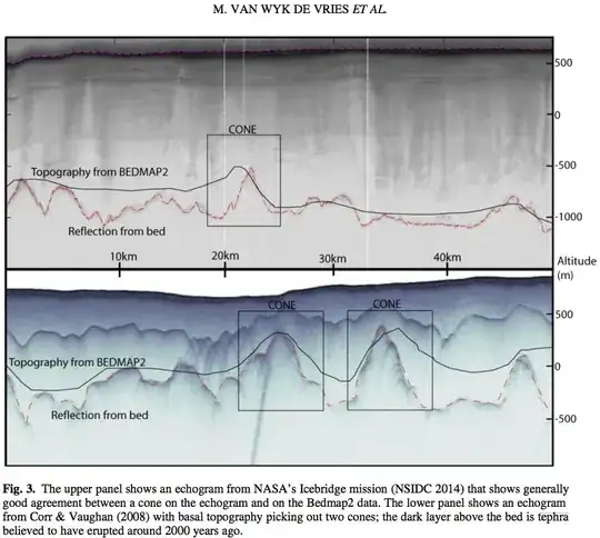

Below is a screenshot of figure 3, including a cropped subsection. If you open the figure in a new window you can view it at full size. In the subsection there are two rectangles with the word CONE above them. Below these words there are two traces. If I understand correctly, the lower trace is (for lack of better vocabulary) the surface of the Earth, and those cones have been identified as volcanos. However I believe the upper trace is the top of a layer of tephra:.
Tephra is fragmental material produced by a volcanic eruption regardless of composition, fragment size or emplacement mechanism.1
Volcanologists also refer to airborne fragments as pyroclasts. Once clasts have fallen to the ground they remain as tephra unless hot enough to fuse together into pyroclastic rock or tuff.
I'm trying to understand what might have happened here. the two cones are of the order of 10 km apart, and they extend above and below sea level. Was there an eruption below the ice which acted as a buffer and contained the ejecta? With some melting, some water below the ice could help it to flow over time and redistribute more evenly between the cones. Or would these volcanos just blow the ice away completely for an extended period of time and Southern Ocean currents could assist in the redistribution?
Fig. 3. (repeated here in case the original is not easily legible on your device) The upper panel shows an echogram from NASA’s Icebridge mission (NSIDC 2014) that shows generally good agreement between a cone on the echogram and on the Bedmap2 data. The lower panel shows an echogram from Corr & Vaughan (2008) with basal topography picking out two cones; the dark layer above the bed is tephra believed to have erupted around 2000 years ago.

That's a very interesting study, but only provide very rough information on the posible volcanoes that might exist under the ice. In the case of the volcanoes shown in the radargram I'll highlight some points that might be the source of your confusion:
  • The tephra layer that overlay the volcanoes in the radargram was not erupted by those volcanoes. It was most likely erupted by a volcano from above the ice (subaerial), or a subglacial one far away. It was later buried deep in the ice by the snow falling on top. Otherwise the layers would be much messier in the area and of varying thickness.
  • If those cone are volcanoes, its shape suggest that they were formed before they became covered in ice. Subglacial eruptions form flat-topped volcanoes with steep sides calles Tuyas, and what is observed are broad shield-type cones, that suggest submarine or subaerial formation.
  • They don't know if those volcanoes are active, but if one were to start an eruption, wouldn't be of the explosive type, because are likely to have fluid basaltic lavas, like the ones observed in Hawai'i. The explosiveness will come from the steam produced. It is hard to tell if it will blow the ice on top or not. It depends on ice thickness, eruption power, etc. But it is definitely a possibility for a strong enough eruption.

  • This is great, thanks! OK with your helpful insight, I'll go back and re-read the papers. – uhoh Feb 01 '18 at 00:16
