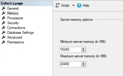

The SQL Server memory configuration is as follows:
SQL Server Memory Configuration

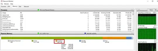

The overall memory consumption looks like this:
Overall Memory consumption

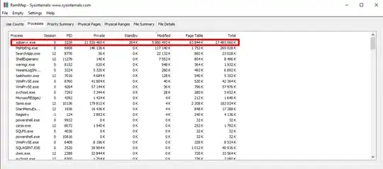

When I look at what consumes this modified memory, I can see it is the SQL Server:
RAM map output

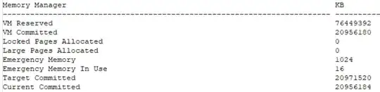

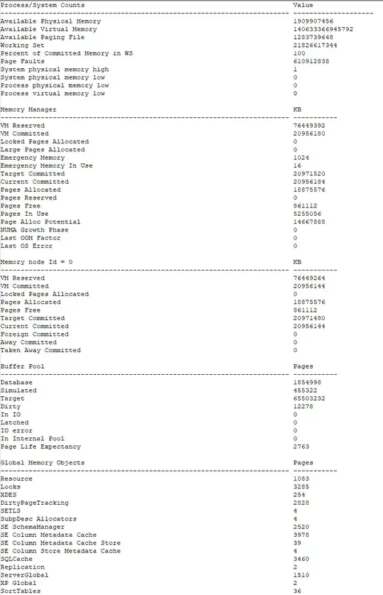

Also the output from the DBCC MEMORYSTATUS does not gives me any clue about what this "Modified memory" portion could be. As I understand the output (see below) the memory consumption reported by the DBCC MEMORYSTATUS fits into the limit set in "Maximum server memory".
DBCC MEMORYSTATUS output
Do you have any idea, what could cause the kind of memory consumption far above the value set in "Maximum server memory" or how I can investigate further?

  • The actual problem is that the "Max memory" settings says 20480MB, but the SQL Server consumes actually over 27000MB. I am able to track what consumes the 20480MB portion, but not able to track what consumes the additional memory up to 27000GB. At some point it turns into to the OS memory pressure. I know that the "Max memory" settings does not cover all the memory that can be consumed by SQL Server, but has never encountered so big difference and so I would like to understand what exactly consumes it, so that I can decide what to do next. – Martin Karouš Mar 14 '24 at 11:28
    If you look at your DBCC MEMORYSTATUS the committed is actually your MSM. Not all memory is held under the MSM - modules, thread stacks, heap allocations, etc. so yes, by default it was always be able to go above MSM. https://learn.microsoft.com/en-us/sql/database-engine/configure-windows/server-memory-server-configuration-options?view=sql-server-ver16 – Sean Gallardy Mar 14 '24 at 14:00

Modified memory is essentially, without getting too deep, memory that has been modified and must be written to disk before it can be reused. SQL Server has a buffer pool (and various other internal and external memory items) whose job is to literally read and write data. SQL Server caches data in memory for this purpose. SQL Server will modify a ton of memory. You can feel free to use etw tracing to find changes to memory, dump those pages out and see what's modified but it's pointless. Let me give you the answer, someone ran a query, it needed data or made changes to data, the memory was modified. The max server memory is set too high for the configured server (with everything else it is running) and now you're seeing the modified memory counters.
Now that you have your answer how is this going to help? Much as I stated, it won't.
You have an XY problem. You're focused on the wrong thing and won't let go of it. It's time to let go, see the forest, stop going against what the people you've asked for help are telling you.
There are many resources on here explaining max server memory in addition to the link I gave:
From your own screenshots, the max server memory is being as it was configured.
The assumption as I stated, is that SQL will only use 20 GB which is incorrect. Images, thread stacks, heap allocation, and a whole host of other things do not fall under max server memory, much as it is stated in the link I had previously given you. You take backups? Cool, that outside it too. I see SQL Agent is running, did you account for that? Also SSMS is running, what about that? I see lots of 3rd party items, and all that memory was accounted for as well? The thread stacks, images, 3rd party dlls and their heap allocation, etc., were all accounted for in this magical 32 GB of memory that was allotted?
Set the max server memory lower, remove any 1st or 3rd party dlls (linked servers, etc.), and don't run a ton of other things on the server.
Let the modified memory thing go, please, it's useless in this context as I previously stated.
