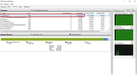

When Total used memory reaches over 25 GB of RAM again, you can check how much SQL Server consuming RAM, using Windows Resource Monitor (Memory tab)
It is also possible that some other application consumes your memory, Resource Monitor can help to confirm that (or otherwise prove SQL Server overblowns the limits)

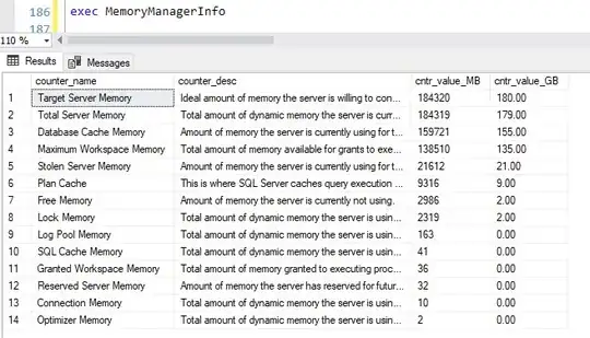

Also, check how much memory SQL Server is currently using, try stored procedure "MemoryManagerInfo"
https://github.com/aleksey-vitsko/Database-Administrator-Tools/blob/master/Memory%20-%20MemoryManagerInfo.sql
Deploy it to any user database and run. Post the output to the question
It will be similar to below picture:
MemoryManagerInfo
This SP will help to confirm or disprove that your SQL Server is consuming over 22497 MB
Look for "Target Server Memory" and "Total Server Memory" values

Based on screenshots you added today to the question - 1) Windows Task Manager (what you posted is not Resource Monitor) says your SQL Server is using 23,281,112 KB which is = 22.2 GB
Not 25.3 GB ! Other 3.1 GB are just other applications
If you worry about your server starving off memory, reduce Max Server Memory in SQL Server to a lower number (20 GB, 19 GB, 18 GB etc.)
Resource Monitor
