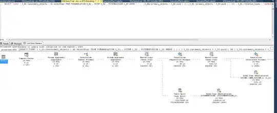

We migrated from Oracle to SQL Server and we have some quite strange behaviours. It might be related to a problem during migration.
I found it hard to interpret the execution plans. Both environments should have the same structure and indexes. Statistics should be up to date. Settings in SQL Server:

Oracle

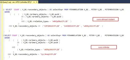

We found out that the issue is / was related and depend on the data. If I select a different item to copy in the GUI (it's actually a copy thing and any how the app does these statements) it works instant. The query then once working fine looks a little different: https://www.brentozar.com/pastetheplan/?id=SJo-h2c44
SELECT  COUNT ( t_01.rsecondary_objectu ) AS selectExpr FROM PIMANRELATION t_01 , PITEM t_02 , PITEMREVISION t_03 WHERE ( ( ( ( t_01.rprimary_objectu = t_02.puid ) OR ( t_01.rprimary_objectu = t_03.puid ) )  AND ( t_01.rrelation_typeu = 'w8INy241VJFL2B'  ) ) AND t_01.rsecondary_objectu IN  ('wBHZpD0uVJFL2B' , 'V2PlBGlAVJFL2B' , 'lnHlBGlAVJFL2B'  ) )
SQl Server seems to completely struggle with the one I mentioned before (running infinite) while providing the second one almost instantly. That's so crazy weird. Like a buggy product.
I don't have influence on the statements as they are produced by the app.
CE 110 / 70 results in the same plan. Even if disable all custom indexes and only keep the ones suggested by the app it behaves the same. All primary keys are clustered indexes. But maybe something messed during our migration. But it's quite strange. Most stuff runs fine, but the query at topic is extreme. I let it run für 45 minutes in SQL Server. It simply does not complete.

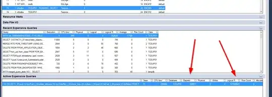

An other example. Our Prod Environment gets unuable once the highest rated index is created:
Index: CREATE INDEX EN_PIPRELEASESTATUS_1 ON [TCEUP01].[dbo].[PRELEASESTATUS] ([pname], [pdate_released]) INCLUDE ([puid])
Results in this query: https://pastebin.com/Ax3qTUjd ===>Took 137.142 seconds
our Test Environment, which should be the same, behaves differently: https://pastebin.com/0PTZTJpr ===>Took 3.884 seconds
the problematic plan looks like this: https://www.brentozar.com/pastetheplan/?id=Skvy0qRNE
and it seems it can run like infinite. enter image description here

The SQL Server query optimizer has a rule that can transform OR into UNION ALL: SelToIdxStrategy. There's no documentation for this and the only reference I could find is this answer. However, that rule will not be applied in this context. Instead, you get two cross joins which can only be implemented through nested loop joins. For each relevant row in PIMANRELATION, SQL Server will cross join to all rows in PITEM, then cross join to all rows in PITEMREVISION, and will finally filter out rows after that. You can easily end up with trillions of rows getting filtered down.
I have bad news for you. If you truly cannot change any part of the query text and you need that query to perform well then SQL Server probably isn't the right platform for your application. Databases have different strengths and weaknesses and you may need to change your queries to accommodate those differences.

  • btw... that select statement killed the whole application, it stuck for all 1000 users. That stuck behavior was gone once we set READ_COMMITTED_SNAPSHOT to OFF. It was enabled for us. I was suggested to do so on many forums so... at the end we all learn. that does not solve that endless statement, but at least the db keep usable. – Krautmaster Feb 20 '19 at 12:50

  • this is indeed the case yeah. Problem is that sql server struggles with that query and oacle is, faulty as it might be, provides a number within seconds. The sql server thing pushes my Maxopt amounts of threads to 100% and it seems not to complete at all. I can hardly imagine that i can make my app avoiding this weird select statement. – Krautmaster Feb 07 '19 at 13:12

We just found the issue on our second statement, which gave this execution plan:
The problem was an unexpected value/param in the query which did not exist in the table PRELEASESTATUS. So I guess it needed to fully scan the table for that non existing value.
Anyhow, the SQL Server reacts quite strangely to this param, having the index on the table the server almost stops while without this index, it runs quite fine. So the param together with the index caused that issue.
I can reproduce it in our test environment that way. I would expect that it would be at least as fast as without that index if the provided value can't be found in the tables...but the SQL Server seems not to realize that its query doesn't make much sense and by sparing the new index it would be way faster.
