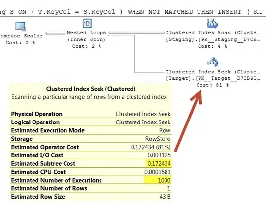

In the queries below both execution plans are estimated to perform 1,000 seeks on a unique index.
The seeks are driven by an ordered scan on the same source table so seemingly should end up seeking the same values in the same order.
Both nested loops have <NestedLoops Optimized="false" WithOrderedPrefetch="true">
Anyone know why this task is costed at 0.172434 in the first plan but 3.01702 in the second?

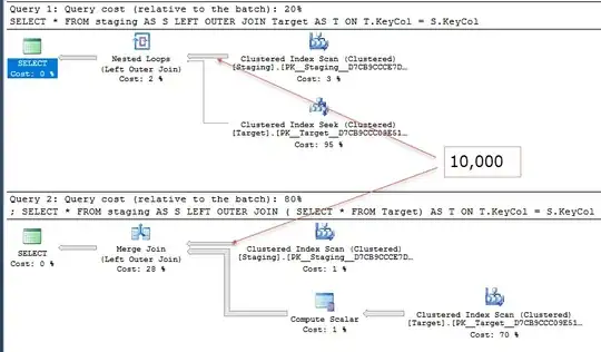

@Joe Obbish points out in the comments that a simpler repro would be
SELECT *
FROM staging AS S
  LEFT OUTER JOIN Target AS T
    ON T.KeyCol = S.KeyCol;
vs
SELECT *
FROM staging AS S
  LEFT OUTER JOIN (SELECT * FROM Target) AS T
For the 1,000 row staging table both of the above still have the same plan shape with nested loops and the plan without the derived table appearing cheaper, but for a 10,000 row staging table and same target table as above the difference in costs does change the plan shape (with a full scan and merge join seeming relatively more attractive than expensively costed seeks) showing this cost discrepancy can have implications other than just making it harder to compare plans.

Simplified queries with execution plans.
SELECT S.KeyCol,
       S.OtherCol,
       T.*
FROM staging AS S
SELECT S.KeyCol,
       S.OtherCol,
       T.*
FROM staging AS S
  LEFT OUTER JOIN (
                  SELECT *
                  FROM Target
                  ) AS T
The main difference between these equivalent queries that really could result in identical execution plans is the compute scalar operator. I don't know why it has to be there but I guess that is as far as the optimizer can go to optimize away the derived table.
My guess is that the presence of the compute scalar is what is mucking up the IO cost for the second query.

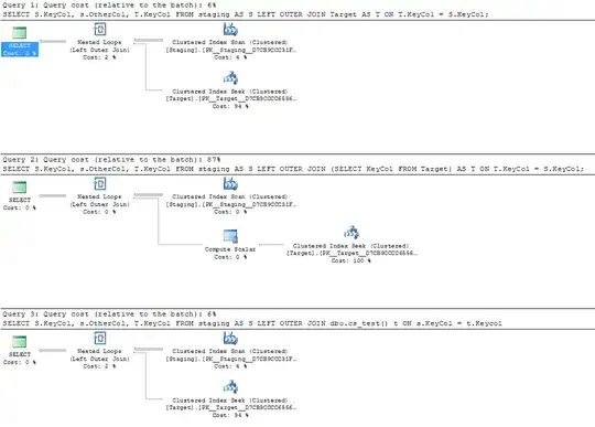

This is not really an answer either - as Mikael noted, it's difficult to discuss this problem in the comments...
Interestingly, if you convert the subquery (select KeyCol FROM Target) into an inline TVF, you see the plan, and its costs, are the same as the simple original query:
CREATE FUNCTION dbo.cs_test()
RETURNS TABLE
WITH SCHEMABINDING
AS
RETURN (
    SELECT KeyCol FROM dbo.Target
/* "normal" variant */
SELECT S.KeyCol, s.OtherCol, T.KeyCol
FROM staging AS S
    LEFT OUTER JOIN Target AS T ON T.KeyCol = S.KeyCol;
/* "subquery" variant */
FROM staging AS S
    LEFT OUTER JOIN (SELECT KeyCol FROM Target) AS T ON T.KeyCol = S.KeyCol;
/* "inline-TVF" variant */
FROM staging AS S
    LEFT OUTER JOIN dbo.cs_test() t ON s.KeyCol = t.Keycol
The query plans (pastetheplan link):
Deduction leads me to believe the costing engine is confused about the potential impact this type of subquery can have.
