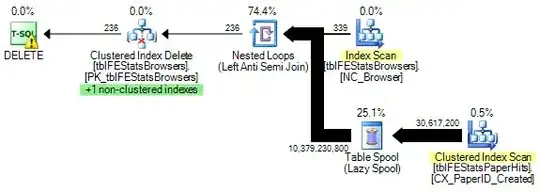

When I run your script to create a statistics only database and the query in the question I get the following plan.
Plan
The Table Cardinalities shown in the plan are
  • tblFEStatsPaperHits: 48063400
  • tblFEStatsBrowsers : 339
So it estimates that it will need to perform the scan on tblFEStatsPaperHits 339 times. Each scan has the correlated predicate tblFEStatsBrowsers.BrowserID=tblFEStatsPaperHits.BrowserID AND tblFEStatsPaperHits.BrowserID IS NOT NULL that is pushed down into the scan operator.
The plan doesn't mean that there will be 339 full scans however. As it is under an anti semi join operator as soon as the first matching row on each scan is found it can short circuit the rest of it. The estimated subtree cost for this node is 1.32603 and the entire plan is costed at 1.41337.
For the Hash Join it gives the plan below
Hash Join
The overall plan is costed at 418.415 (about 300 times more expensive than the nested loops plan) with the single full clustered index scan on tblFEStatsPaperHits costed at 206.8 alone. Compare this with the 1.32603 estimate for 339 partial scans given earlier (Average partial scan estimated cost = 0.003911592).
So this would indicate that it is costing each partial scan as being 53,000 times less expensive than a full scan. If the costings were to scale linearly with row count then that would mean that it is assuming that on average it would only need to process 900 rows on each iteration before it finds a matching row and can short circuit.
I don't think the costings do scale in that linear way however. I think they also incorporate some element of fixed startup cost. Trying various values of TOP in the following query
SELECT TOP 147 BrowserID
FROM [dbo].[tblFEStatsPaperHits]
147 gives the closest estimated subtree cost to 0.003911592 at 0.0039113. Either way it is clear that it is basing the costing on the assumption that each scan will only have to process a tiny proportion of the table, in the order of hundreds of rows rather than millions.
I'm not sure exactly what maths it bases this assumption on and it doesn't really add up with the row count estimates in the rest of the plan (The 236 estimated rows coming out of the nested loops join would imply that there were 236 cases where no matching row was found at all and a full scan was required). I assume this is just a case where the modelling assumptions made fall down somewhat and leave the nested loops plan significantly under costed.
