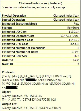

Here is a screenshot of the clustered index scan operator for that query:
full scan in simple query
So if the SQL Server query optimizer is deciding between different plans and one of the plans has an artificially low cost for a required step then it seems unlikely that I will get a different plan, even if that plan seems absurd to me personally.

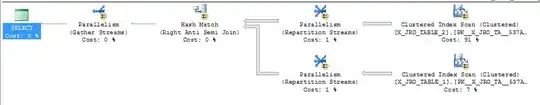

If I increase the sample size of the stats on JOIN_COLUMN for X_JRO_TABLE_1 or X_JRO_TABLE_2 then the cost of the full scan on X_JRO_TABLE_2 goes up. With a large enough sample size I believe that we hit a tipping point that makes the row count spool plan inferior to other plan choices including just a regular table spool. Here is a screenshot of the query plan after I gathered stats in full:
query plan of query after stats update
