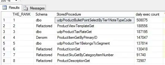

I have been monitoring the execution of my stored procedures in my webservers in order to tune them for best performance.
I will call the procedure that has most executions per day as myprocedure and its code is here:

This procedure receives a parameter @ListNoteTypeCode that is used inside the procedure to convert into a table variable all the possible values, most of the time one single value.
the table variable, later is used in a join.
how can I improve the performance of this stored procedure? the bit with the xml part is high cpu intensive, is there another way to pass a table to a procedure, making best usage of CPU?
I still have to run a good trace and identify how often this procedure results in more than one value in @ListNoteTypeCode, but regardless of this I still need to find a solution.
