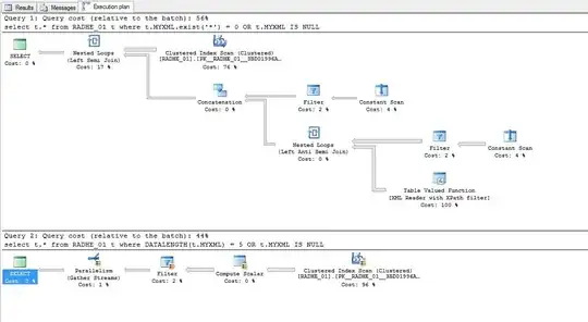

This is the execution plan (picture) from sql server enter image description here
This is the full XML execution plan of the query and picture above.

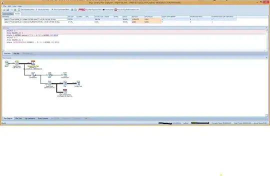

This is another picture using another tool to compare execution plans. enter image description here
Conclusion:
Using DATALENGTH on this occasion, for this situation, has been proven quicker.
