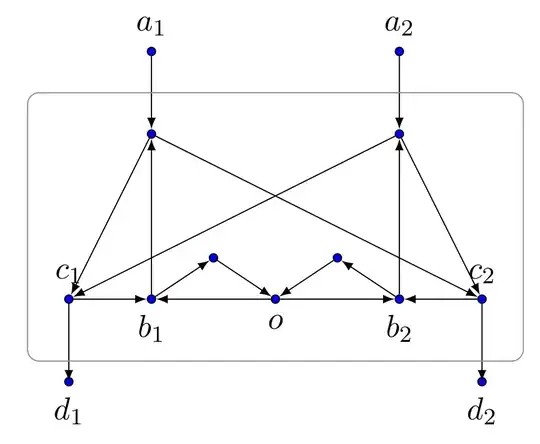

Warning: this does not completely solve your question because the gadget is not planar. But since I could not find a proof of this, I think it might be worth posting.
Speckenmeyer proved that the undirected feedback vertex set problem is NP-hard on planar graphs with maximum degree of four. I try to adapt his gadgets to directed graphs. However, I cannot keep the planarity. But it satisfies the degree bounds.
We replace a vertex $x$ by this gadget and assign the entering arcs to $a_1$ and $a_2$, and the leaving arcs to $d_1$ and $d_2$. (It does not matter who receives two.)
In the gray box, there are four directed triangles. We need to remove at least two vertices to break them. The only choice is $\{b_1, b_2\}$. This corresponds to a solution not containing $x$. On the other hand, a solution containing $x$ can be replaced by $\{o, c_1, c_2\}$.

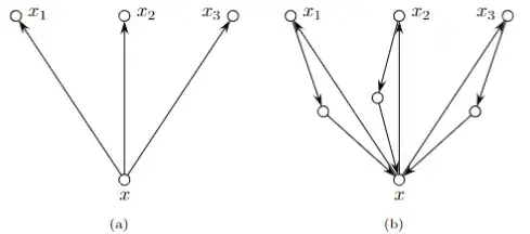

Thanks to Prof. @Yixin Cao's construction of the reduction, I think I have found a way to show that Planar-DFVS remains $\textsf{NP}$-hard when $(\Delta_{in}, \Delta_{out}) = (2, 2)$.
We use the Vertex Cover in planar $3$-regular Hamiltonian graphs to reduce.
Let $G$ be an instance of Vertex Cover in planar $3$-regular Hamiltonian graphs. $G$ is bridge-less, since $G$ is Hamiltonian. According to Peterson's theorem, $G$ has a perfect matching, and let $M$ be a perfect matching of $G$.
STEP 1.
For each edge $e$ in $G$, we add a new $2$-degree vertex $w_{e}$ connecting the endpoints of $e$.
If $e$ is in $M$, we orient the triangle containing $w_{e}$ in the anticlockwise direction; otherwise, we orient the triangle in the clockwise direction.
Let $x$ be a vertex in $G$. Without loss of generality, suppose there are one clockwise directed triangle and two anticlockwise directed triangles containing $x$.
Now, the in-degree and out-degree of every vertex are exactly three.

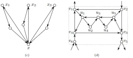

STEP 2.
Based on Speckenmeyer's method, we use a gadget to replace each vertex $x$.
As Prof. Cao's statements, in the dotted box, there are four directed triangles. To Break all of them by using two vertices, we have a unique choice $\{u_{1},u_{5}\}$. This corresponds to a solution not containing $x$. On the other hand, a solution containing $x$ can always be replaced by $\{v_{1}, u_{3}, v_{3}\}$ or $\{v_{2}, u_{3}, v_{4}\}$.
Therefore, we obtain a planar digraph with $(\Delta_{in}, \Delta_{out}) = (2, 2)$.
