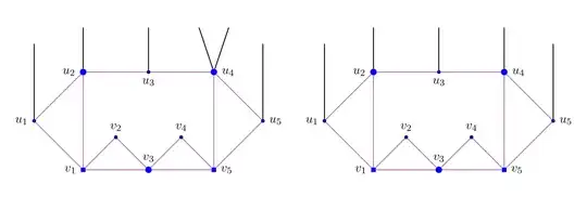

gadgets
Here are the two gadgets Speckenmeyer used in his Ph.D. thesis. We can start from planar graphs with maximum degree six, by a reduction from the vertex cover problem on cubic planar graphs. (Actually, we can start from a general planar graph and use similar gadgets to reduce its maximum degrees.) We replace a vertex $x$ of degree six with the left gadget and a vertex $x$ of degree five with the right gadget. A solution $S$ to the original problem will be translated as follows:
if $x\in S$, then we take $\{u_2, u_4, v_3\}$; otherwise $\{v_1, v_5\}$.
Since the feedback vertex set problem can be solved in polynomial time in cubic graphs, even if they are not planar, the issue is settled. Source: http://dx.doi.org/10.1016/0012-365X(88)90226-9
